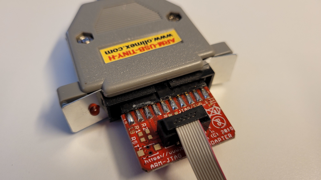

I think I have an essential problem that I don't know how to attach the ARM-USB-TINY-H and ARM-JTAG-20-10 :/
I understood from here https://github.com/bitcraze/AIdeck_exam ... ramming.md how to attach ARM-JTAG-20-10 to the Crazyflie, but I don't know how to attach the ARM-USB-TINY-H to them. Also, to do those things, is it necessary to attach the Crazyradio PA to my computer? Or must I attach the ARM-USB-TINY-H to the computer? Because I don't have the required USB port :(

For me the ARM-USB-TINY-H and ARM-JTAG-20-10 are "keyed" to know how to connect them, are they not for you?

No, I didn't know how to do it until I posted that, then I saw the description of the problem here: viewtopic.php?f=21&t=4649 after that, I understood how to link them.
I think that this is must explain in the documentation of the AI deck for the naive users. Also, I imagine that it is beneficial to add USB type B to the hardware requirements. I hope you accept my suggestions :)
Although I attached the ARM-USB-TINY-H and ARM-JTAG-20-10 correctly as the picture and used the USB type B, I get the same problem.
