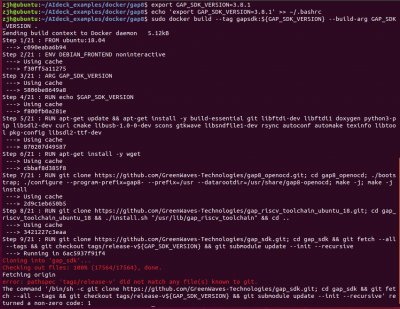

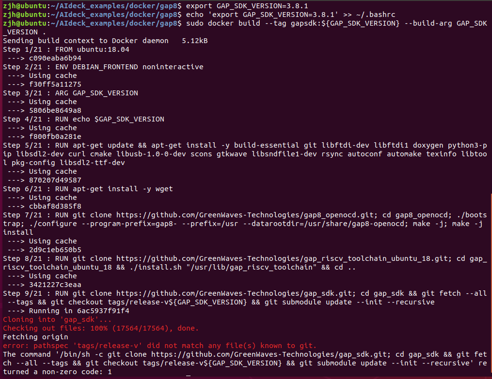

I took your advice to use docker.
And I have solved some problems in the process these days, but the following error I did not find a good solution on the Internet. I don't know if you have any suggestions.
It has to be said that if you directly install the SDK, it is too complicated. However, with docker, due to China's network restrictions, there are various error reporting problems. I hope you know the solution to this git problem.
Step 9/21 : RUN git clone https://github.com/GreenWaves-Technologies/gap_sdk.git; cd gap_sdk && git fetch --all --tags && git checkout tags/release-v${GAP_SDK_VERSION} && git submodule update --init --recursive
---> Running in 6fede4792f51
Cloning into 'gap_sdk'...
Checking out files: 100% (17564/17564), done.
Fetching origin
error: pathspec 'tags/release-v' did not match any file(s) known to git.
The command '/bin/sh -c git clone https://github.com/GreenWaves-Technologies/gap_sdk.git; cd gap_sdk && git fetch --all --tags && git checkout tags/release-v${GAP_SDK_VERSION} && git submodule update --init --recursive' returned a non-zero code: 1

- Posts: 1050
Re: AI-deck can't release WiFi
hi!
This does not seem that it is a internet restriction problem. Make sure that you have the right SDK version defined before starting to build the docker file. This means that you need to (in your local machine) define the SDK version like this in the terminal:
Or add it to the ~/.bashrc file and restart the terminal again
currently this seems to not have been done correctly due this error in your previous message:
This is supposed to be 'tags/release-v3.8.1' (because of git checkout tags/release-v${GAP_SDK_VERSION}), so currently ${GAP_SDK_VERSION} is not defined in your terminal
I would say, please try again to go through the docker guide but make sure to read every step.
export GAP_SDK_VERSION=3.8.1
echo 'export GAP_SDK_VERSION=3.8.1' >> ~/.bashrc
I did follow the guidelines.But it still reports errors, as you can see in the attachment.In the past, I have successfully passed this step.I've never met this error report.(Instead, an error will be reported at the back, saying that the connection cannot be made raw.githubusercontent.com.That's what I mean by China's Internet restrictions)
As for the present problem, I did take the first two steps.And it's never been wrong, except this time.It doesn't help that I've reinstalled the virtual machine.
- Posts: 1050
that is odd indeed. Reinstalling the virtual machine should not make any difference so let's investigate a little bit.
1- Could you open the .bashrc file by:
and check if 'export GAP_SDK_VERSION=3.8.1' is at the end of the file?
2- If you see it, restart the terminal or do
3- And double check with
This should print the number 3.8.1
4- After that, build again but then with the --no-cache option:
And check if you are getting the same echo at step 4/21
gedit ~/.bashrc 2- If you see it, restart the terminal or do
source ~/.bashrc
echo ${GAP_SDK_VERSION}
docker build --no-cache --tag gapsdk:${GAP_SDK_VERSION} --build-arg GAP_SDK_VERSION .
