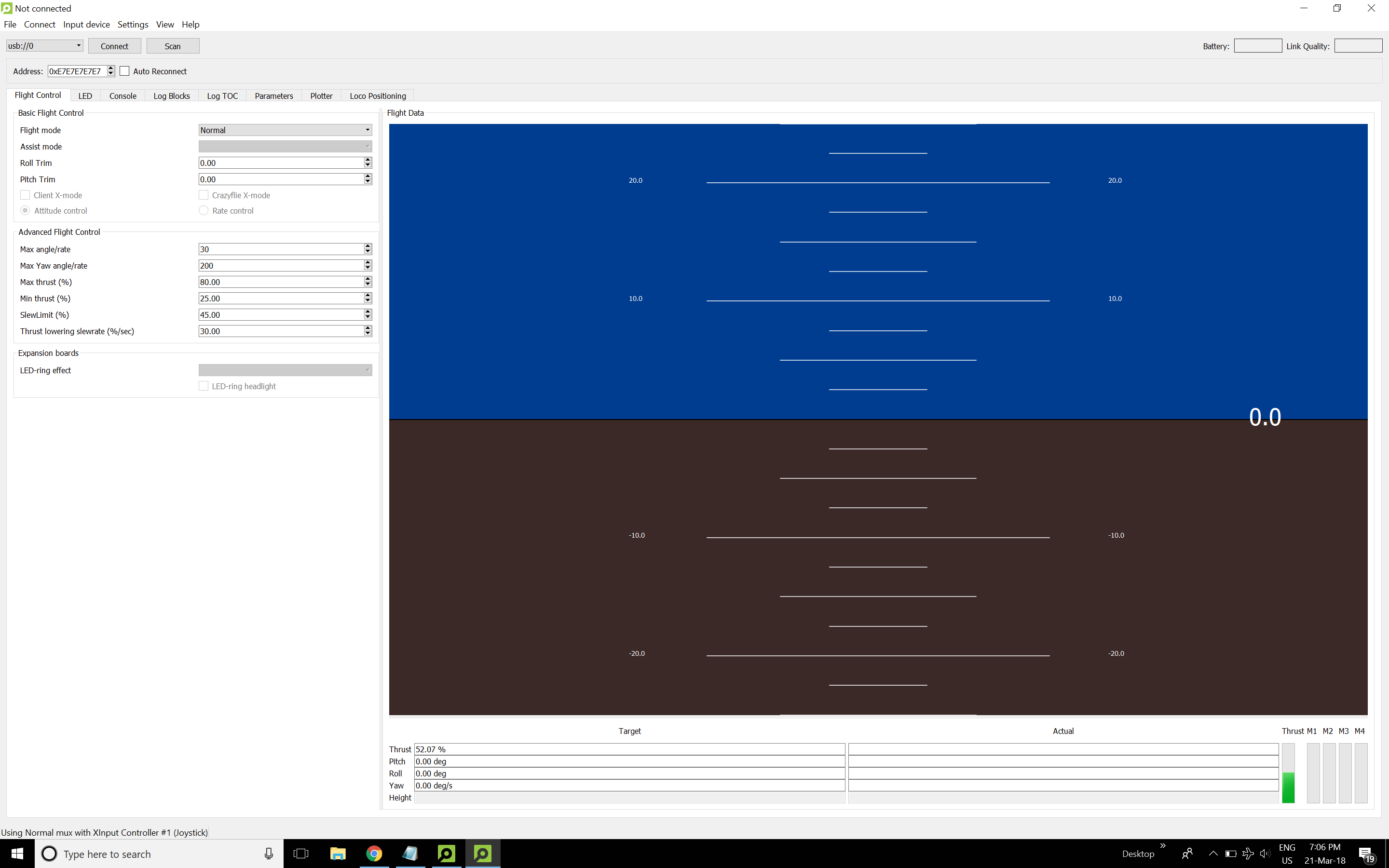

I have installed cfclient-win32-install-2018.01.3.exe on my windows 10 PC and followed the steps mentioned at https://www.bitcraze.io/getting-started ... /#inst-win. In the Crazyflie PC client when I click the “Scan” button in the top left corner, it never discovers Crazyflie 2.0 drone. I checked the following list before asking help here -

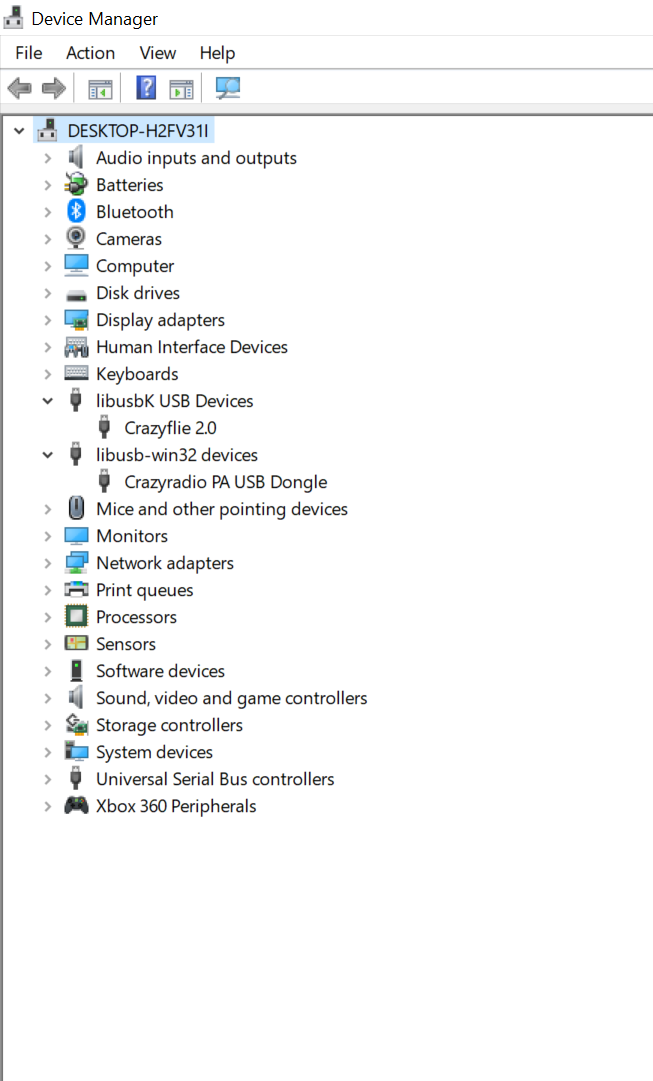

(1) I tried with both Crazyradio PA drivers - libusb-win32 (v.1.2.6.0) and libusbK (v.3.0.7.0). In both cases, I am able to see Crazyradio PA USB dongle in windows device manager.

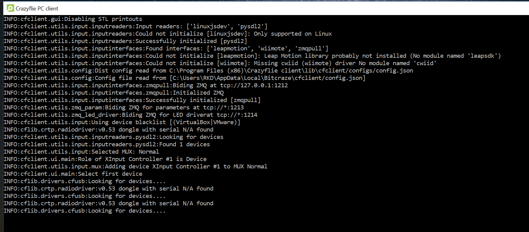

(8) I got tried with the message INFO:cflib.crtp.radiodriver:v0.53 dongle with serial N/A found

Everything you are doing looks right so one thing I am thinking is that your Crazyflie might be on an address which is not the default one. Maybe this Crazyflie was used by someone else before?
To verify the radio address you can connect the Crazycflie with usb, go to "connect/configure 2.0" and check the radio channel, datarate and address. It is advised to use a Datarate of 2Mbps and the default address should be 0xe7e7e7e7e7. Once you have written the default address you can try to scan again.

Thanks for your prompt reply. Yeah, someone used my drone earlier. I reset those parameters as you suggested. EEhhh, it is now connected :lol:
