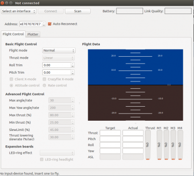

I meet problem to connect crazyradio with my PC.
I installed crazyflie client on my Ubuntu 16.04. I start the client software, and cannot find crazyradio connected.

Hi Arnaud
When I power on the crazyflie, LED on M1 keep blink in red.
After start client, it still cannot found devices. The log showed on terminal is showed as below,

It looks like I didn't set crazyflie address correctly.
I checked drone address over usb cable and set the adress to client software. It now can connect to crazyflie !
Just thinking it might be better to have a function to scan drone address automatic.
Thanks
