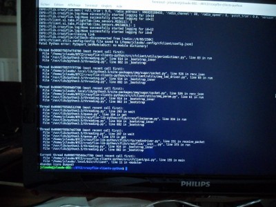

Also an error "Fatal python error" due to persistent threads:
I wrote down the console message for two different runs:

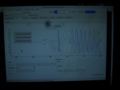

To add to my analysis of the behaviour of my cf2, I wrote down the graph of Gravity vector during an unsteady flight : After the lost of balance, the system begins a steady large oscillation...
At the exit of the client, there are Python error messages: Jean-Claude

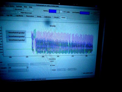

My feeling is that my problem is not in the calibration process but in sensor fusion.
As you can see in: giving the gravity of sensorfusion6. I just shake briefly cf2 between 340 and 350 seconds. Then fusion enter in a hard oscillation process lasting dozens.
I had the same oscillatory behaviour after a unsteady flight.
Perhaps a wrong parameter value in my parameter TOC?
Jean-Claude
Jean-Claude

More information:
After a shock with my finger, IMU sensors are immediately stable, but sometimes with non zero values although cf2 is perfectly fixed and horizontal.
If shaking 2 or 3 times, the gravity vector enters quasi steady oscillation with damping half-period around 1 minute. After 2.5 minutes there are still visible oscillations.
Jean-Claude
More information:
Jean-Claude
