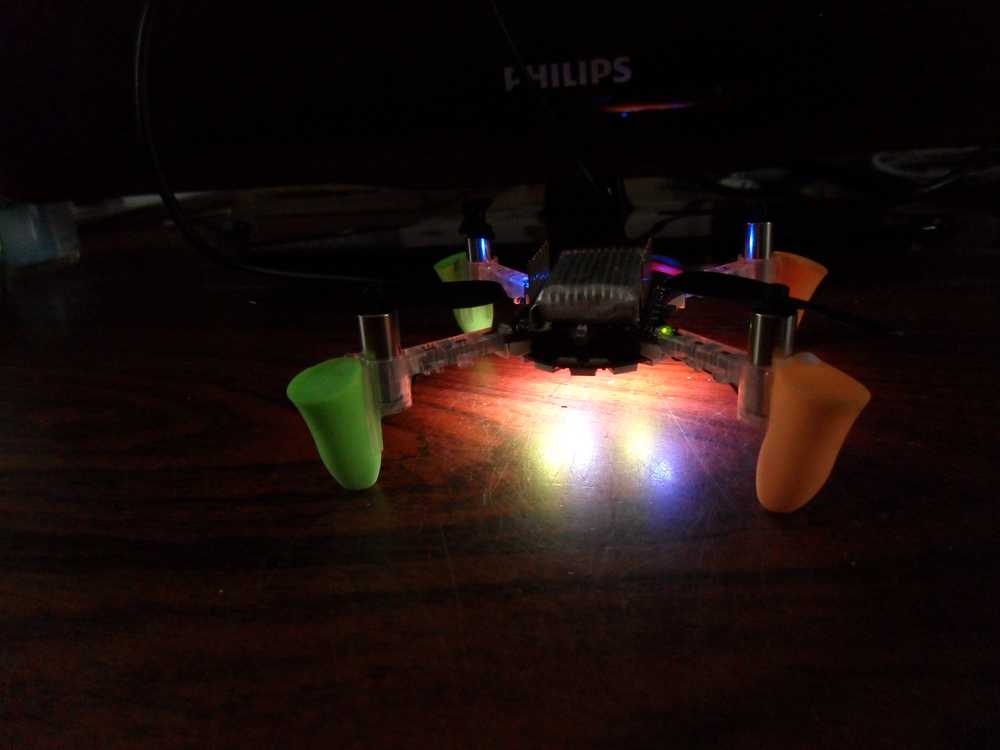

There is no deck. Only shock-absorbers as it can be seen be seen on the attached photo.

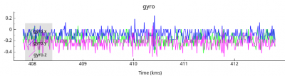

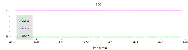

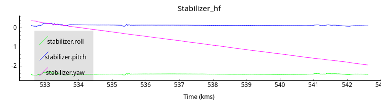

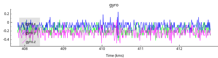

Downwards are some information from the plotter. The cf is maintained fixed in horizontal position:
Stabilizer
A slight drift can be seen for yaw. Not really a problem.
gyro
acc
motors
I do not understand the the variation for cf and throttle are fixed... Battery is full charged.

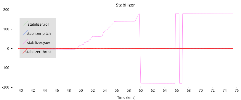

Hi
Another graph. The plot of stabilize.yaw shows heavy discontinuities, around 180°. Is it the problem of brutal lost of stability? Regards

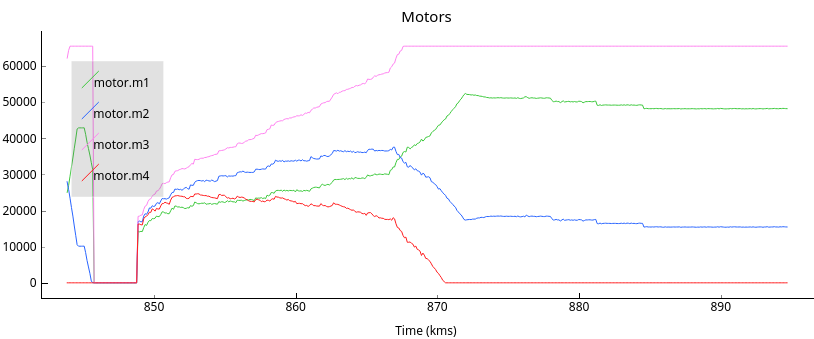

Following:

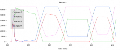

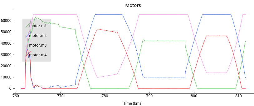

Other very interesting plot, the command of motors.
The throttle est fixed, craft was tilted to put it horizontal: Cf is fixed horizontal, I increase throttle progressively: Cf is fixed horizontal, I put on althold mode: Is my crazyflie entirely out of service (many heavy shocks when beginning to fly)?

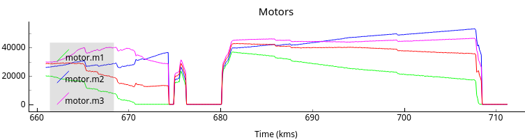

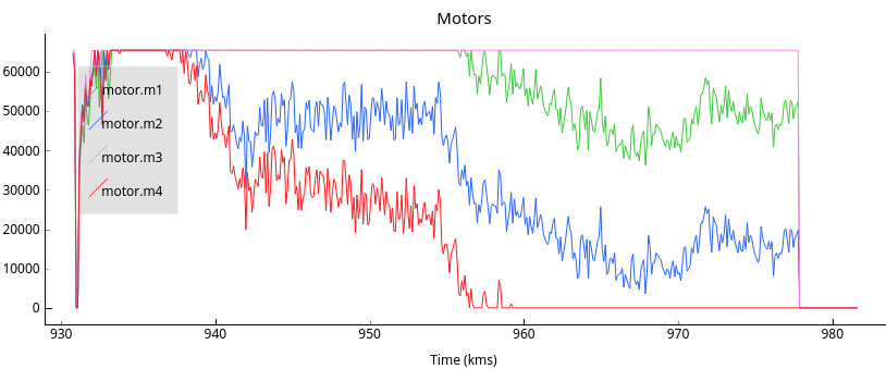

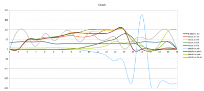

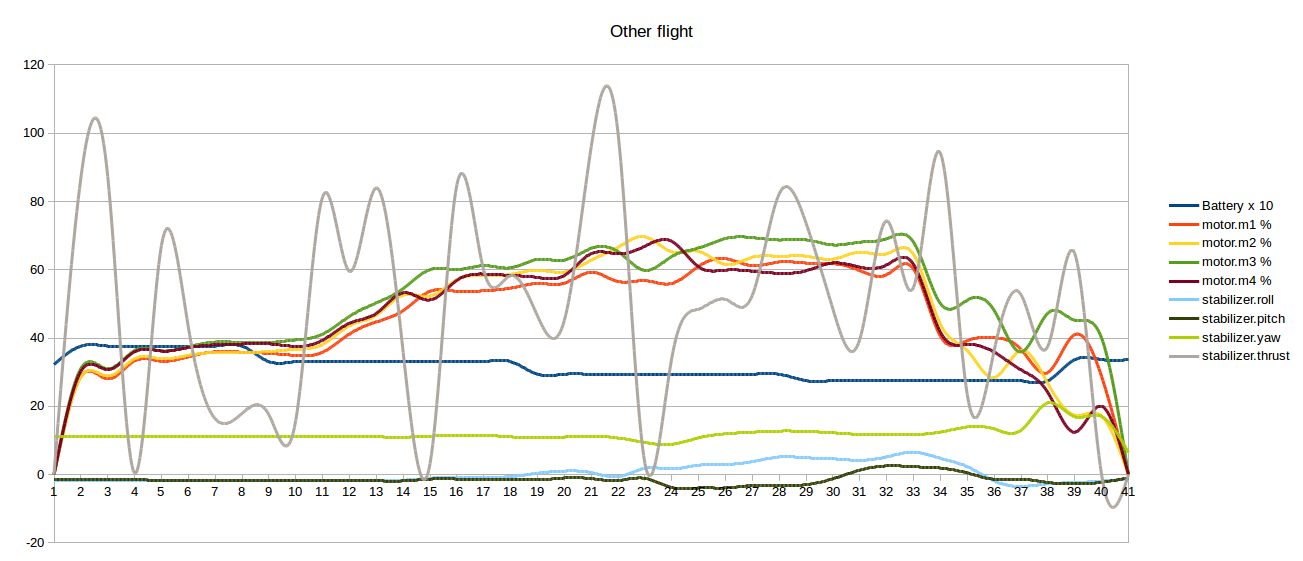

Re: Non-sense

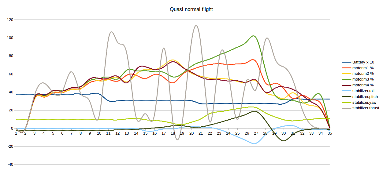

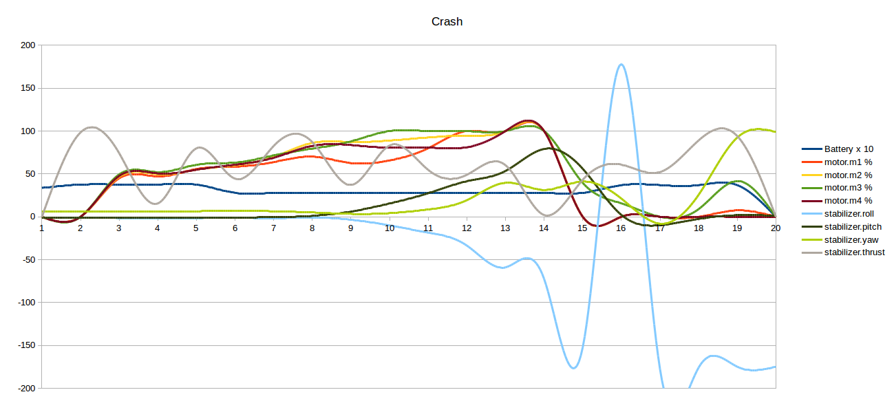

Hi

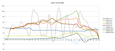

You can see the logs of three flights. The first and second are quasi-normal. Le last one ends with a crash on the back. Stabilizer.thrust presents large oscillations...
