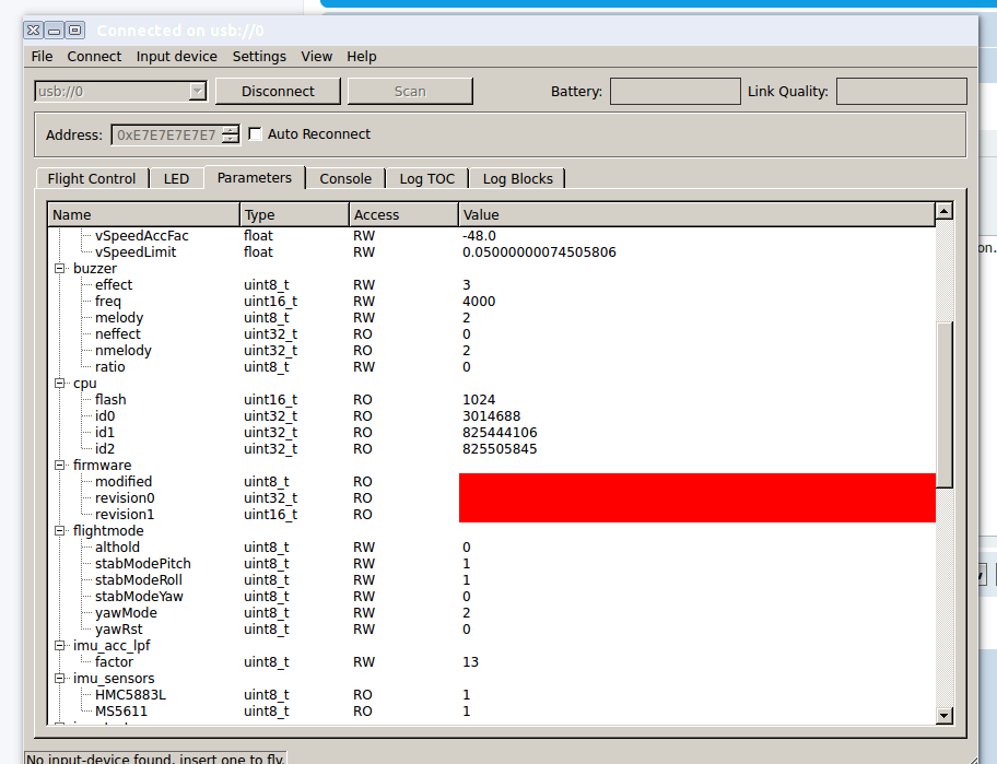

I have a Crazyradio, and can I connect using the cfclient (only from bootloader mode). Sometimes I can connect with the radio, sometimes only via USB (I can't figure out a pattern yet).
Also, occasionally, I've seen the message "Error Updating; Timeout while fecthing nR51 info" instead of the "Timeout while fetching STM32 info" box, however, I can't figure out what circumstances cause the nRF51 message to appear.
I've attached a screenshot of parameters output (note the red in the firmware section).
I can provide any other debugging information, and welcome any troubleshooting suggestions.

Re: Firmware Update Failed (IOS): Timeout while fecthing STM32 Info
Here this screenshot I mentioned in my last post:
Re: Firmware Update Failed (IOS): Timeout while fetching STM32 Info
What happens if you try flashing it from the cfclient with the crazyradio? My guess is that the STM32 bootloader is the problem. Did you flash this one or did you build it your self and flash it? Did you use this command?
sudo dfu-util -d 0483:df11 -a 0 -s 0x08000000 -D cf2loader-1.0.bin-
