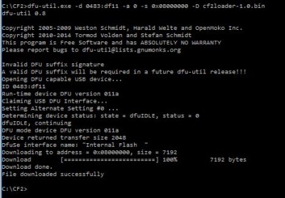

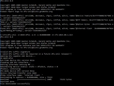

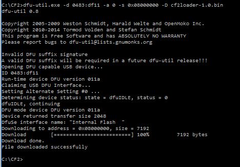

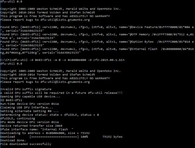

Indeed I used the instructions here. I attached a screenprint of the output when I run dfu-util --list and the upgrade sequence. It appears to run successfully...but the device is stuck in blue light mode. Any ideas?

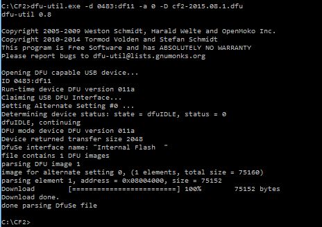

Thank you, I tried the DFU using the command at:
https://wiki.bitcraze.io/projects:crazy ... opment:dfu
Which was:
dfu-util.exe -d 0483:df11 -a 0 -D cf2-2015.08.1.dfu
It looked OK ("Download done"), but still in solid blue light state after disconnecting power and reconnecting battery.
