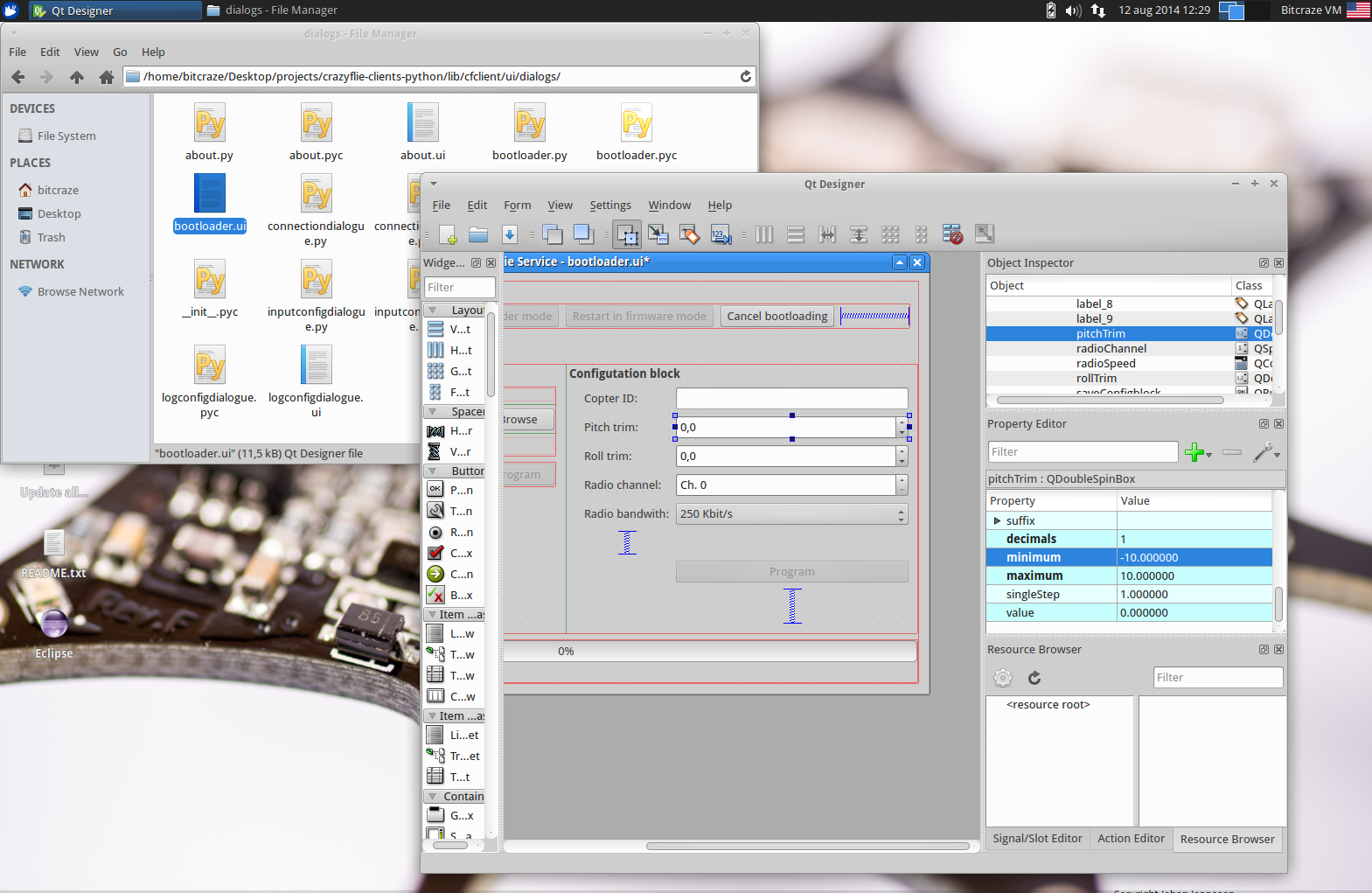

The limitation of trim settings in config block appears to be in the PC software. Assuming you are running the VM you can change it by modifying the bootloader UI file:
- Open the folder project/crazyflie-clients-python/lib/cfclient/ui/dialogs/ and double-click on bootloader.ui
- It should open Qt Designer.
* Click on Roll or Pitch trim
* in the property editor find "minimum" and "maximum" at the bottom of the list and change them to a high enough number.
* Save and restart the Crazyflie client to see the change applied.
It is not exactly super easy, but it should work. I attach a screen shoot of what it should look like.
/Arnaud
