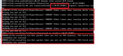

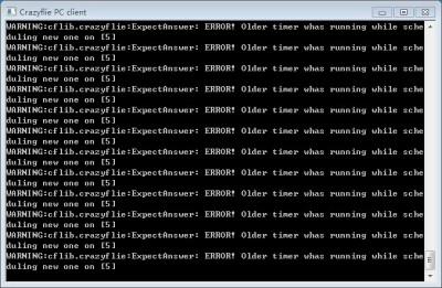

I have tried to use the RADIO links CF,but no link ,As shown in the figure below... According to >?
no link
no link
error
error
note: red led 2hz or 1hz flashing........no connect usb,only battery !tks

It looks like firmware/software compatibility issues. Try upgrading to the latest firmware on the Crazyflie and cfclient.

tobias wrote:It looks like firmware/software compatibility issues. Try upgrading to the latest firmware on the Crazyflie and cfclient.
YES ,I feel ......
but...pls checking follow it ......
not secceed
not secceed
what's this "TOC Channel" ???

Please upgrade to the latest client/firmware and this should be fixed. The TOC channel is a logical channel used for downloading a table of content of the variables that can be logged and set as parameters.
