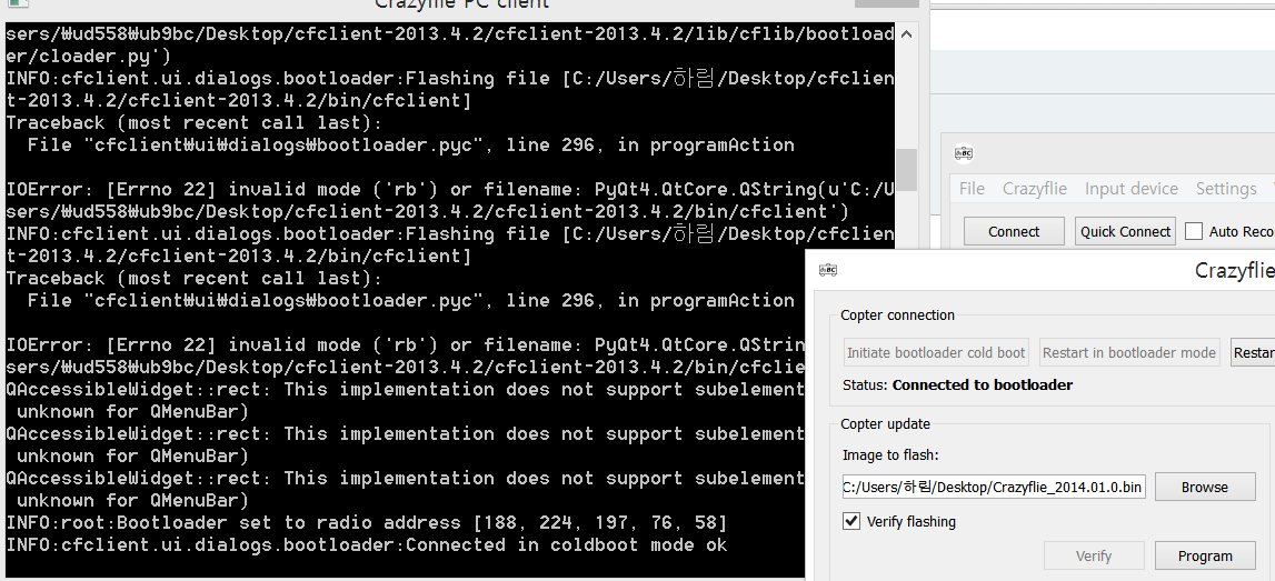

i just got this crazyflie , and i just try to upgrade this toy with new firmware but i couldnt do it
plz help me to upgrade my copter
this happening when i click the programm button
i cant uprate my crazyflie

I've never seen this before. I will let Marcus know about it, he probably knows what the problem is. (access rights?)

yes when i click the program buttontobias wrote:I've never seen this before. I will let Marcus know about it, he probably knows what the problem is. (access rights?)

Re: i cant uprate my crazyflie
There seems to be an issue with the directory naming and support for the language. The workaround is to place it the file in a directory with only English letters. I've added an issue for this here.
Is the user home-directory in Korean?
