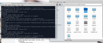

I keep getting the error :IOError: [Errno 2] No such file or directory: 'cradio-0.52.bin'
As you can see from the attachment "cradio-0.52.bin" is in the "/home/bitcraze/projects/crazyradio-firmware" folder so I don't understand the issue.

Ok I manage to upgrade the crazyradio firmware.
I had to use the Bitcraze VM version 0.3 without running the update script first.
Re: Firmware Upgrade Issue
Great that you solved it. We will try to reproduce it and fix it if we need to. Thanks for notifying us!
