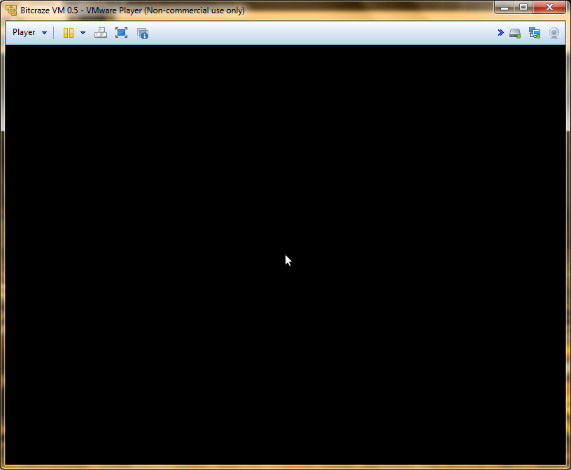

Good morning,
I downloaded the VM 0.5 yesterday and imported it into VMware Player. After starting the VM, the Ubuntu boot screen shows up for some seconds - everything seems fine. But then the boot screen disappears and a black screen with a mouse cursor comes up - and that's it. Even after half an hour nothing else happens. At first the harddisk activity indicator of VMware Player is flashing but stops after a while.
I didn't alter the standard settings of the Bitcraze VM, but I noticed that the OS type setting is set to "Ubuntu 64-bit". But changing that to just "Ubuntu" doesn't help.

EDIT: The attached screenshot shows what I see after the Xubuntu boot screen.

I have seen something similar with the latest Virtual Box on Windows as well. After starting the machine you just see the BIOS Post message and then it's just black. But if you resize the window with the virtual machine it will instantly fix the issue and you can see the desktop.

marcus wrote:I have seen something similar with the latest Virtual Box on Windows as well. After starting the machine you just see the BIOS Post message and then it's just black. But if you resize the window with the virtual machine it will instantly fix the issue and you can see the desktop.
Yes, you're correct. Same problem with VirtualBox. I noticed that if you press Ctrl + Alt + F1 the console shows up. Maybe that's a starting point for further investigation? :?

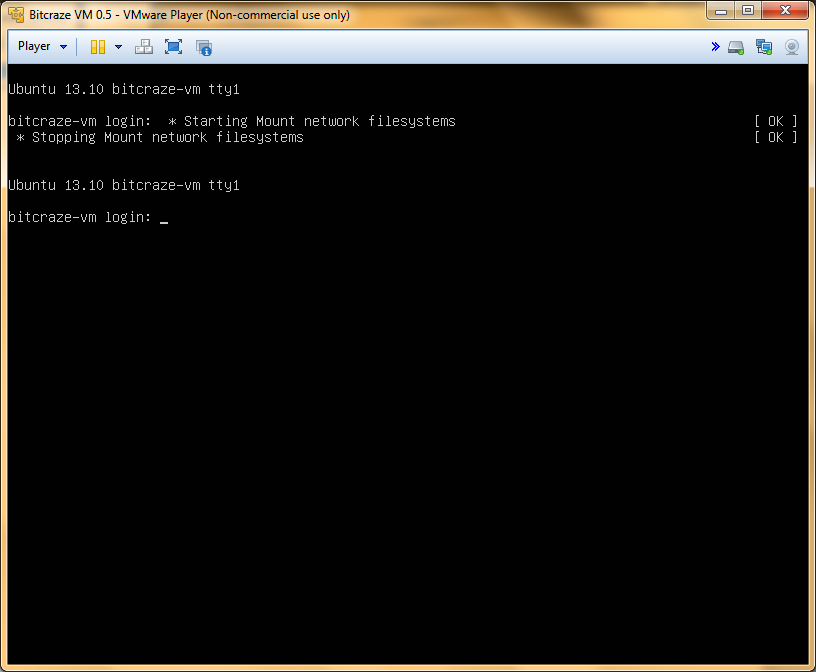

Ok, for VirtualBox the solution actually is resizing the VM window or going to fullscreen - thanks for the tip, marcus!
It seems like VirtualBox is able to switch the resolution according to the VM window size and therefore forces the desktop to update. Unfortunately, this doesn't work for VMware Player. Here the VM window simply shows scroll bars if resized, but obviously isn't able to change the guest's resolution. Maybe the reason for this are the preinstalled guest tools of VirtualBox in the Bitcraze VM.
Thanks for bringing me on track. VirtualBox has made a big development step since the time I had trouble with the USB filter drivers, maybe I'll give it another break.
If you have any ideas for getting the VM to work with VMware Player, let me know. Is there a way of installing VMware tools via console so the guest screen resolution can be altered by resizing the VM window?
By the way, below you find the output after pressing Ctrl + Alt + F1.
