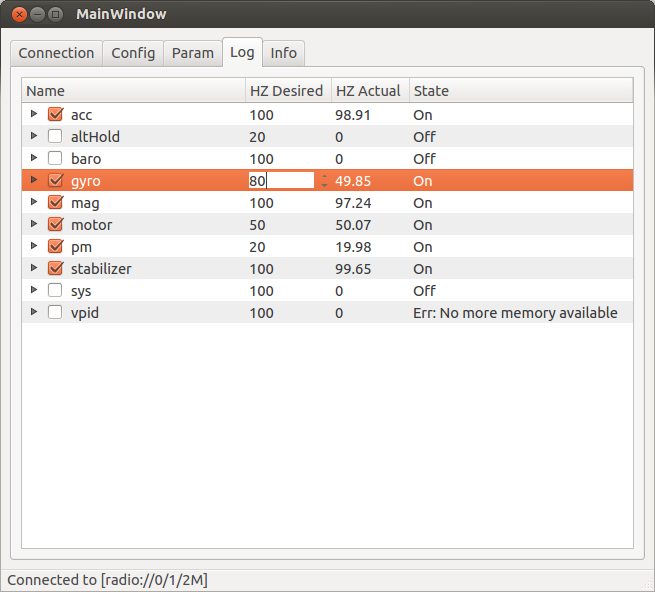

This is what I was working on:
It saves configurations between sessions, monitors/sets the frequencies, and shows error messages in case something fails. When its finished one could wrap it in a tab and submit it to the repo. Its currently implemented as a QTreeWidget that takes a Crazyflie as a parameter. However In my application its the only source of logging (wanted to have that centralized) so it might need some work if being added to the cfclient (it doesnt scan for existing logs configs, but that should be easy enough to fix)
