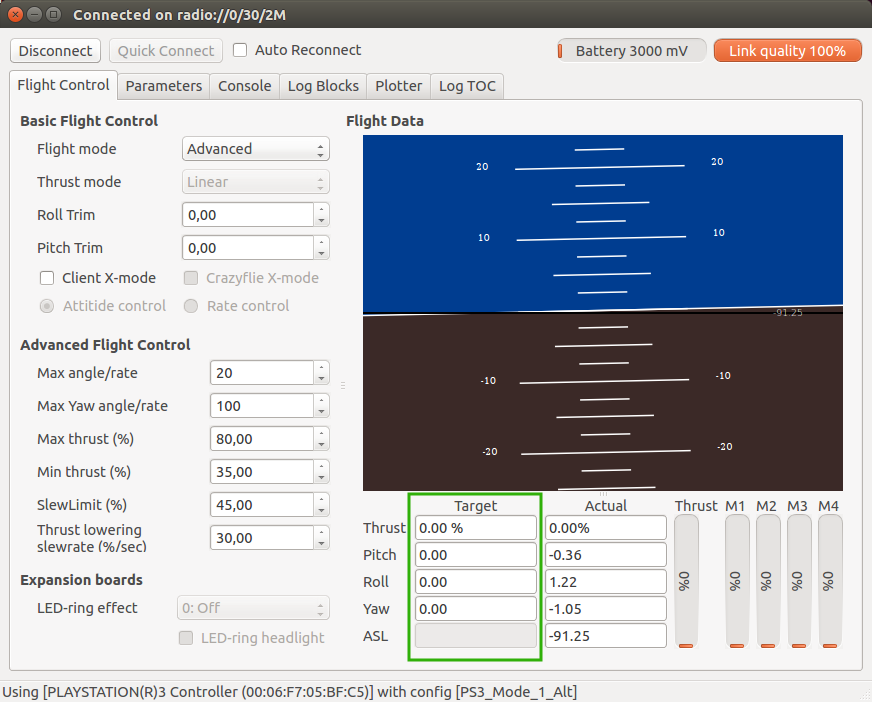

I have a similar problem. Whenever I connect my CF 2.0 to my antenna, it immediately starts trying to take off without me doing anything. Please help! :o
Re: Crazyflie spins uncontrollably
I'm guessing the target values comes from a wrong input driver. When you start the cfclient what does the target values say? If you connect using a mobile device is the behavior the same?
Client target valeus marked in green
