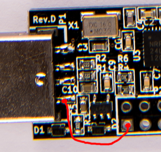

That is strange and the first case I see. Normally the LEDs should turn on as soon as the Crazyradio is powered. I'm have a suspicion that the diode has broken off during shipping. Can you see if the component D1 is missing? It is located just below the USB connector. It is safe to short the two pads where D1 where by soldering a short between them as long as the board isn't powered from the expansion header at the same time (which I don't think you will do). You can also contact Seeedstudio support to have them fix it (as they are responsible for the hardware).

Looks a problem with D1, good guess!
One of the joints looked dry, I gave it a nudge and the whole component crumbled off :S
Will be getting in touch with the shop to arrange a replacement or advice.

OK, great and good luck fixing it. You can just but a little piece of wire which you solder between the pads. It can be a bit tricky though.

Had another look, when lit from behind it looks like the whole pad has come off!
Replacement it is :)

If you want you can still fix it by soldering a small wire according to the picture below.
Solder red wire to fix missing D1 diode
