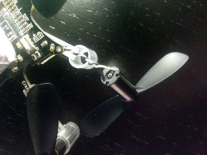

The first time the motor was damaged after a crash (but without any external sign), it required a high level of thrust to start and the fly was not stable. The second time the motor was also damaged after a crash, but this time it was the bottom of the motor (black plastic part) which was damaged by the rotor (because of a collision of the propeller I guess). Picture:
