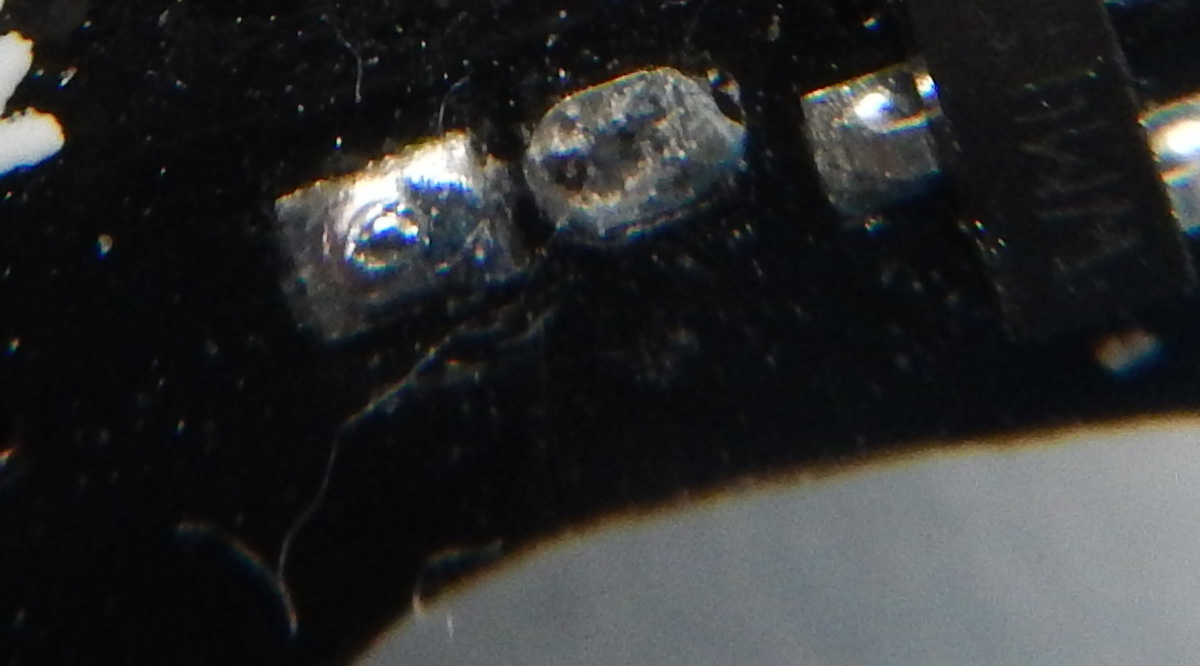

Hello this is the best I have managed to get.
Re: One of quad engines still running while on battery
Do you have access to a multimeter? If you have you can try measuring the resistance like described in this post.
