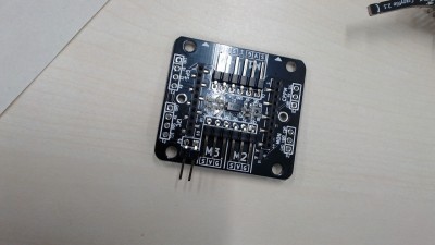

I'm assembling big quadrotor with big quad deck.
And my esc does not have 5v output. Only have signal and GND.
So I try to supply big quad deck with 5v power to from PDB.
Now my question is where should I connect 5v output and GND on the big quad deck.

You can connect the 5V to any free pin marked 5V on the bigquad deck. And the same with ground.

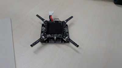

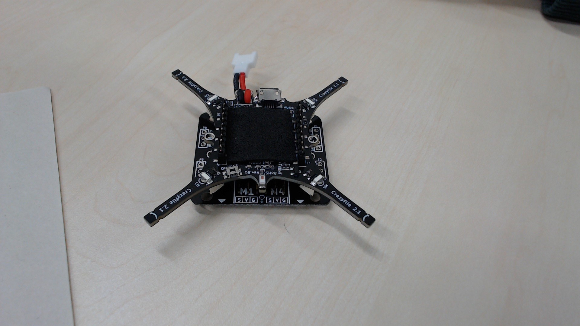

I connect crazyflie and bigquad deck like below. And I use Buzz pin like below. I connected 5V to Buzz pin but crazyflie didn't start.
Is this correct?

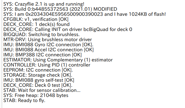

I connect USB to crazyflie and cfclient console show this message. Must the motor be connected to the Bigquad deck?
Please help me.
Thanks.

Re: How to supply big quad deck with 5v power from PDB
Hi bitcraze.
I got it!!
Crazyflie Started!
Thanks!!
I got it!!
Crazyflie Started!
Thanks!!
