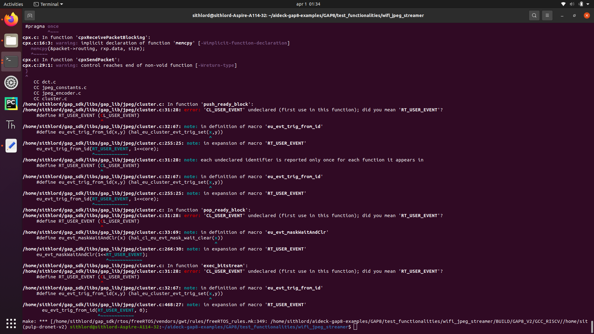

i have been trying to run the wifi_jpeg_streamer examples from the aideck-gap8-examples repo but i get this compiling error:
I have the lastest cf firmware, sdk 3.8.1 and python 3.8.8. Any idea what is causing this?

You should probably update your SDK to at least 4.8, or revert the code back to a commit before any major changes we have done this year.
Mind that the aideck is going through some major changes so that the procedure to flash will change in the coming weeks.

I managed to find an old version of AI_examples and it works now. thanks
