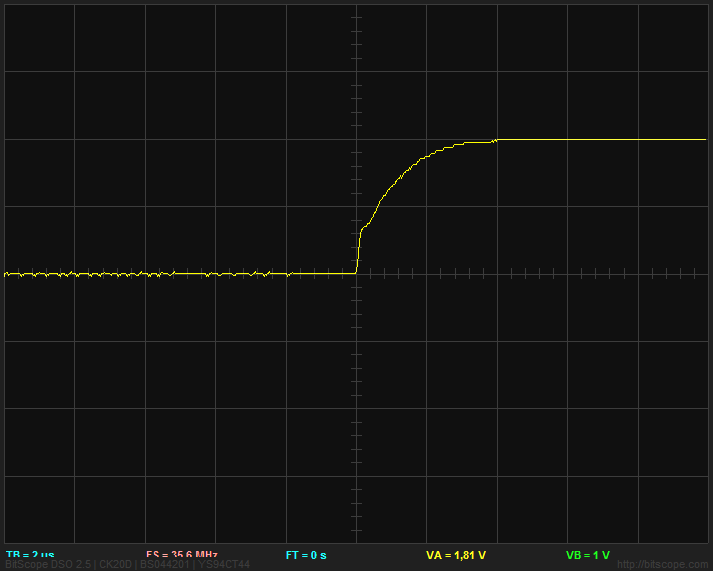

Hi - I found an old oscillator and spent a day trying to get it to work!tobias wrote:Yes, the system doesn't work that well on 1.8V. It is interesting that it does so at all.I guess there is enough juice left for the transmitter?
I would take one of the damaged Crazyflies with the step-up connected and measure the VCOM voltage with a scope during turn on/off to look for any possible voltage spikes. I have attached a graph of the VCOM turn-on without anything connected. It turns on in about 4us. The TPS79301 regulators maximum input rating is 6V so if VCOM gets higher then that I guess it can be damaged.Which tests would you do if you had the equipment?
Here are the results. No voltage spikes, not sure if I am happy or not.
Test setup:
+VCOM (pin 16)
-DGND (pin 17)
Measure voltage during startup without the 5v-step-up -> tx -> cam circuit attached and with the circuit attached.
Anything else I can test while I am at it?
Cheers!
