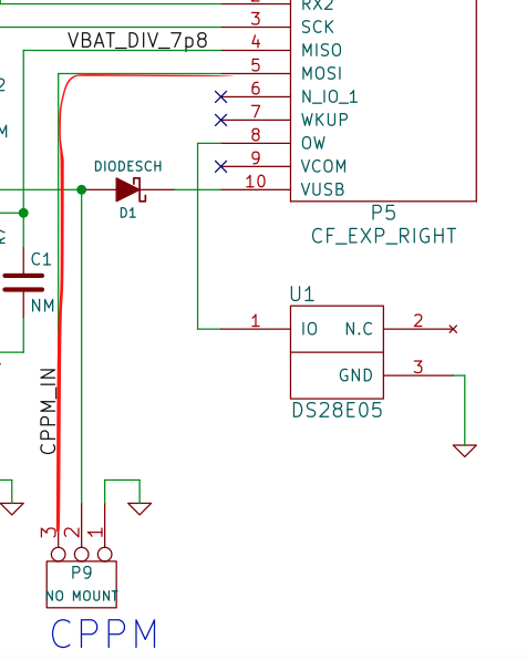

Dear community could you please tell me if there is any option to use an CPPM Receiver with Bolt FC and mounted Flow deck?
a working solutions for me could be to use the pin 5 of the right deck connector wich is used by the big quad deck. (marked in red)

figured out that the bigquad deck wich supplies cppm uses pin 5 on right connector to read signal from receiver.
the flow deck uses pin 5 MOSI for communication to PMW3901MB. is there a possible way to remap the cppm pin?
Re: adding CPPM receiver to Bolt FC with mounted flow deck
Yes as of this #862 pull request it is possible to remap the CPPM input.

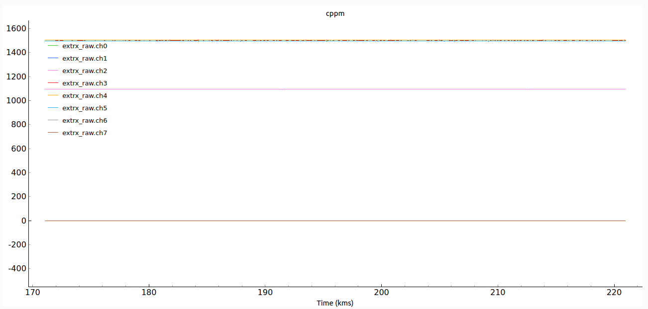

To debug it you can check the cfclient log variables extrx_raw to see the RX channel values and extrx to see the final translated values. You might have to edit the defines like EXTRX_SCALE_ROLL in the top of extrx.c to get scaling and such correctly.

thank you so much that helped a lot and finally I could get it working.
I need cppm with flow deck and assist mode hover.
while using cfclient and takeoff the optical flow works.
After enabling the the transmitter assist mode is disabled and the drone isn't locked in place anymore.
Is it possible to activate position hold alt hold by default?
could it be an alternative to enable it throughparameter?
thank you in advance
