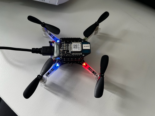

Hello Everybody,
my Crazyfly
is not able to fly correctly and i dont know why....
I'm using following Codes: https://pastebin.com/MgwHyXph .
My Deck is going to be detected.
The result of flying, however, does not meet my expectations. Because the Crazyflie takes off and then slides forward on the ground. And correspondingly lingers on the ground with running engines for a while. The take-off would have to take place in a straight line upwards, or am I thinking of it the wrong way? Is it intended that way, or am I doing something wrong?
Yours Rubics.
