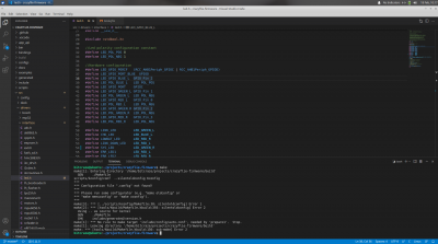

I change the LED code as :#define SYS_LED LED_GREEN_R,
and then I start the build but fail:
how can I solve this problem?I use virtualbox version 6.1,and Bitcraze VM 21.07

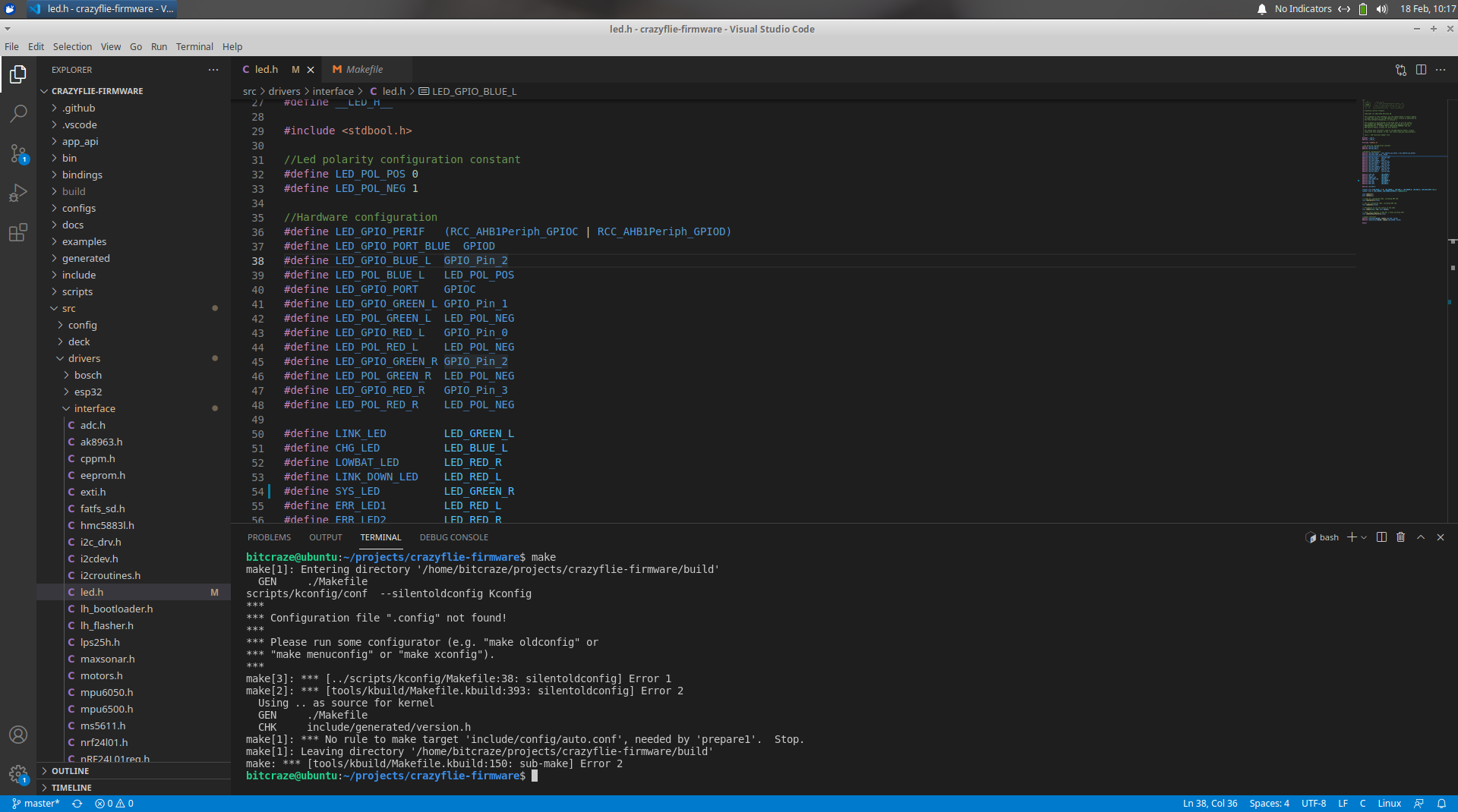

I find that failed firmware version is the latest and different from previously I used. I guess this error may caused by Kconfig file?
- Posts: 1050
Re: error when Build the source code
Yes we have moved to building with the kbuild structure as of this week (See the blogpost: https://www.bitcraze.io/2022/02/a-new-w ... -firmware/)
There is new updated flashing and building instructions can be found in the documentation of the crazyflie-firmware. In your case, you would need to do first
and then
I'll update the tutorial to reflect this better.
make defconfigCode: Select all
make I'll update the tutorial to reflect this better.

Thank you!I get itkimberly wrote: ↑Tue Feb 22, 2022 4:05 pm Hi!
There is new updated flashing and building instructions can be found in the documentation of the crazyflie-firmware. In your case, you would need to do firstand thenCode: Select all
make defconfig
.Code: Select all
make
