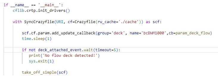

I must admit that I am still quite a beginner. I was doing the Step_By_Step-Guide, given here: https://www.bitcraze.io/documentation/r ... commander/, and a problem has occurred. I don't understand why my deck, which I use, is not found. Can somebody help me out?
According to the client: I'm using the Deck: bcDWM1000.
What i did now is. I just changed the name of my Deck in the given script from the Step_By_Step-Guide:
And unfortunately my deck still can not be found. And i really need some advice, please.

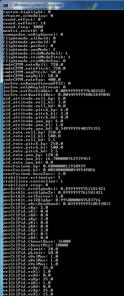

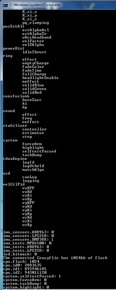

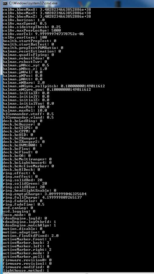

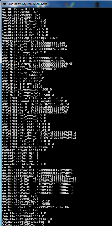

And the Output of the basicparam.py example is this:
As I can see, my deck (bcDWM1000) is also found in that.

RubICS
- Posts: 8
- Joined: Thu Feb 03, 2022 1:16 pm
Re: Deck connection Python_script
Hello jonasdn,
i dont know what you did
, but now my deck is going to be detected. Thank you soooooo much
The Output is:
1
Deck is attached!
yours,
RubIcs
