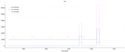

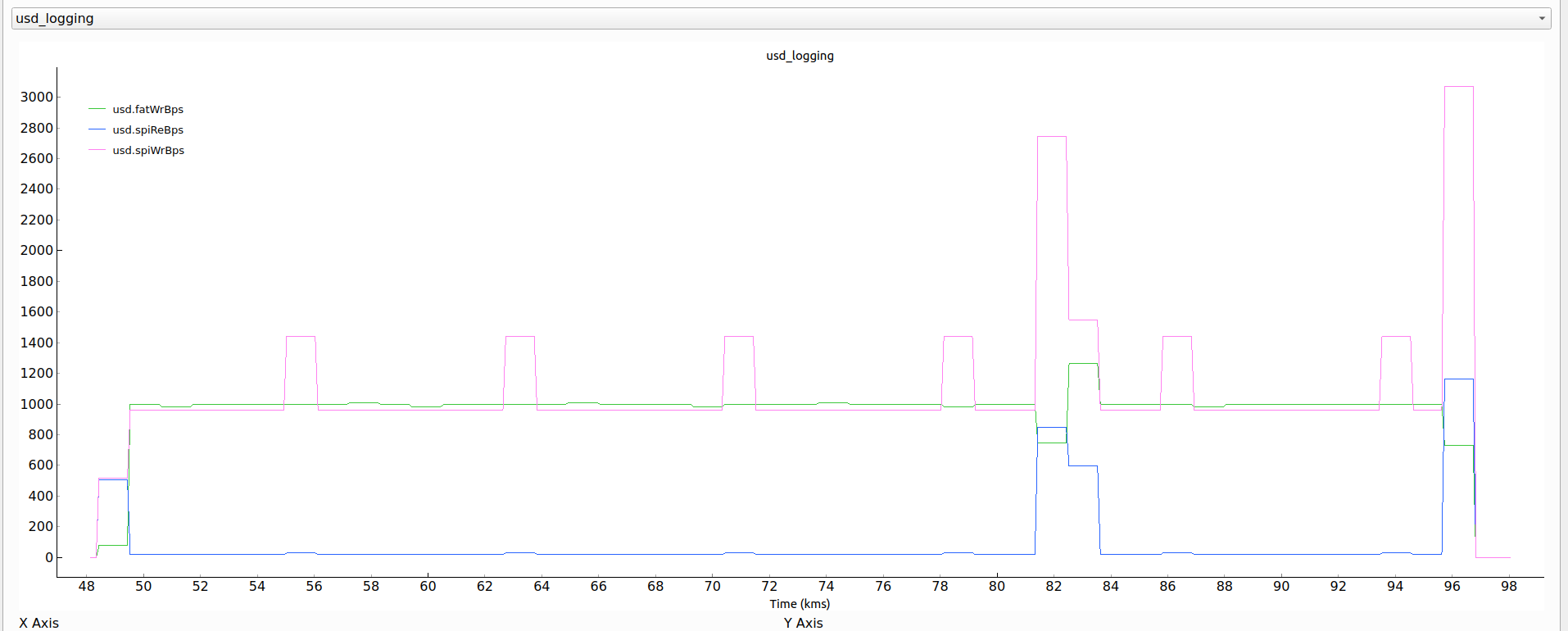

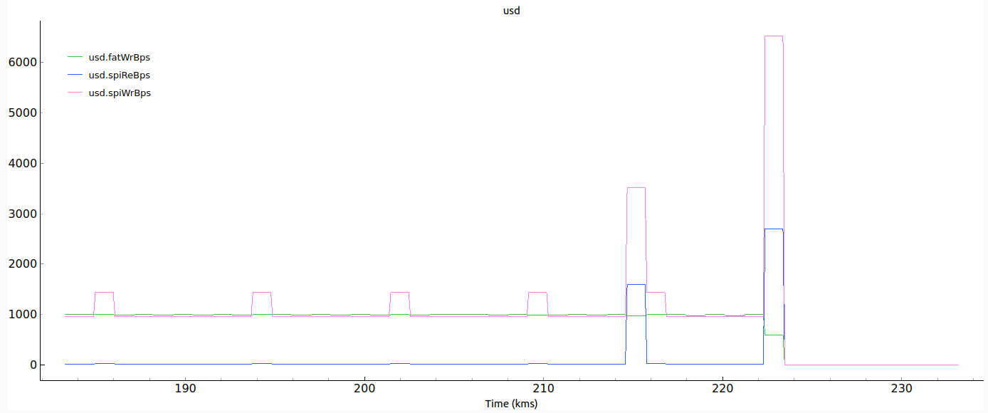

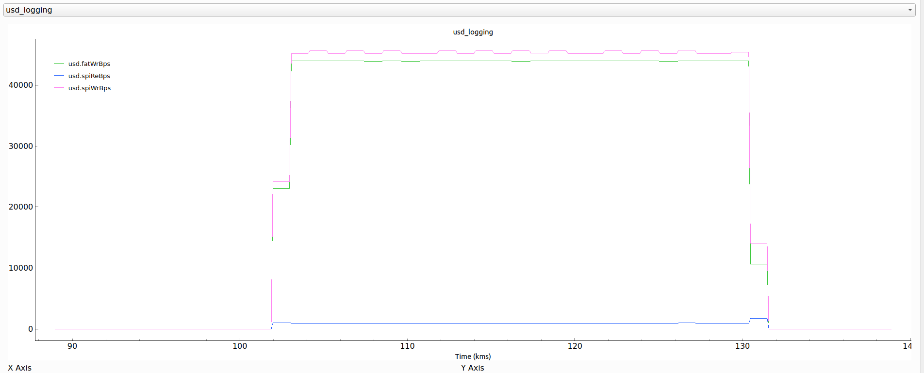

I did some tests (#1 and #2) with 2022.01_rc1 and it worked well for me. I used a Kingston 32GB Class 10 A1 (Canvas select plus). I wonder what the difference for me is, and also why your SD-card doesn't work...

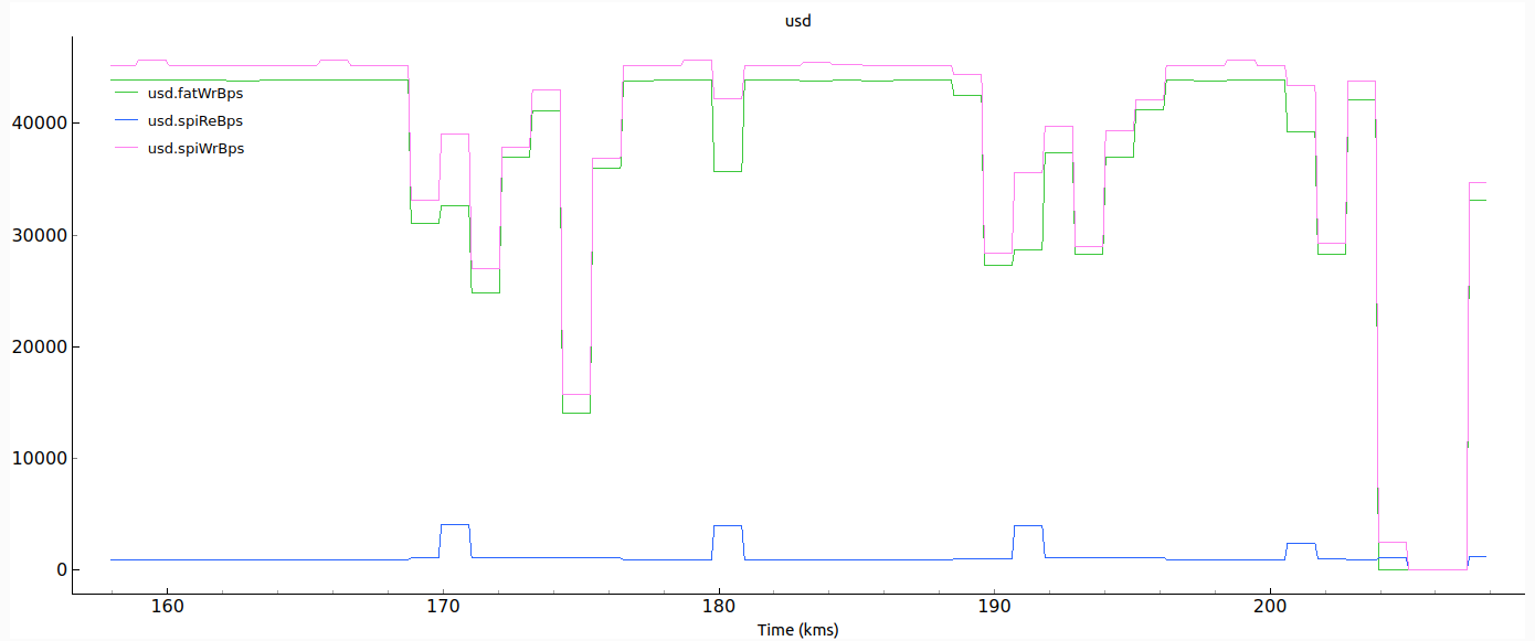

You can check the uSD write rates using the usd log variables. Maybe that will tell us something. Below are mine from my two tests:

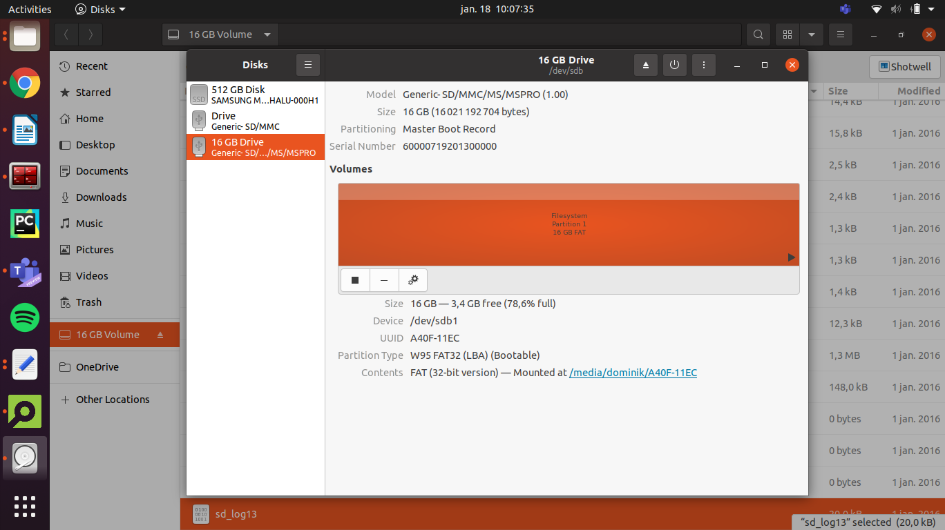

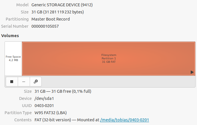

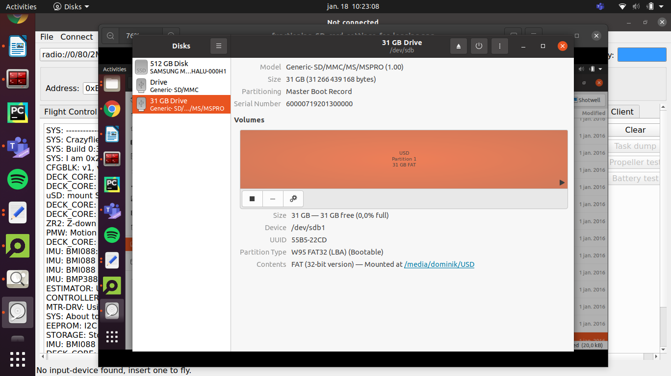

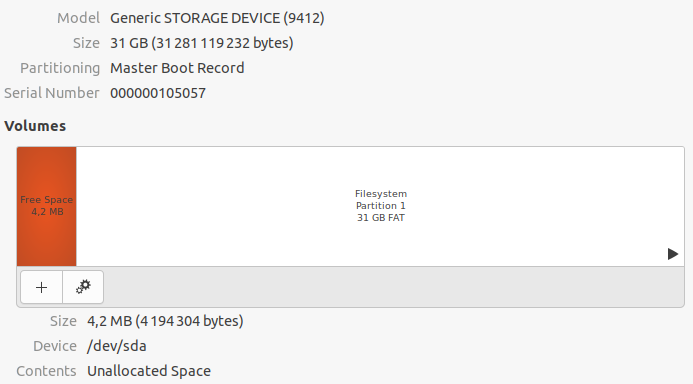

Interesting that your SD card works. Luckily, I've found a third SD card in our office (a Transcend UHS-I microSD 300S, 16 GB, up to 95 MB/s), which seems to work somewhat better. Let's look at details.
All the reports following here use this new SD card. Regarding my UWB setup: I have just mounted the SD deck on the Crazyflie, but no anchors in use. Just like you I too re-performed tests #1 (fixed frequency, all decks) and #2 (event based, all decks). This time I have increased the buffer size to 8192 bytes.

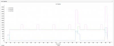

Screenshot of logging variables for test #1:

Screenshot of logging variables for test #2:
Resulting log file for test #2:
The file was too large to be uploaded (1.2 MB).
My observation / assessment:
Fixed frequency still only logs timestamps, despite switching SD card and increasing buffer size.
Isn't this the case for you too? Your writing rates do not look tremendously higher. And when I analyze your log with cfusdlog.py the output is:
{'fixedFrequency': {'timestamp': array([140742.056, 140751.972, 140761.9  , ..., 211669.776, 211679.695,
       211689.619])}}
which I interpret as "only timestamps logged". Please correct me if this interpretation is wrong (aka my fixed frequency logs have been working all the time).
