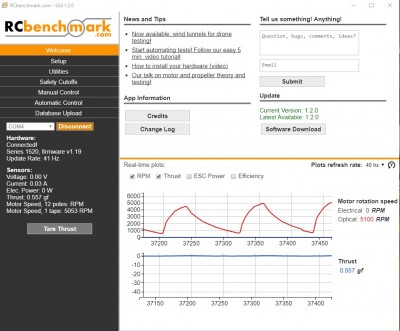

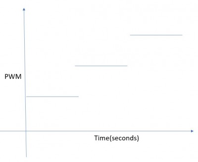

Here is my question. How should I keep a PWM value for a few seconds? or How should I let motor rotates at a constant PWM value for a few seconds just like what it is shown in Fig.1?
I have tried following two ways:(1)I refer to your code https://github.com/bitcraze/crazyflie-f ... ta.py#L139. I have changed the 'time_step =0.1' to 'time_step=3' (assume I want to keep the specific PWM for 3 seconds), but the result is shown in Fig.2.

(2) For the second way that I have tried, I just update your code like the following. However, the result is shown in Fig.3, which is still not right.
