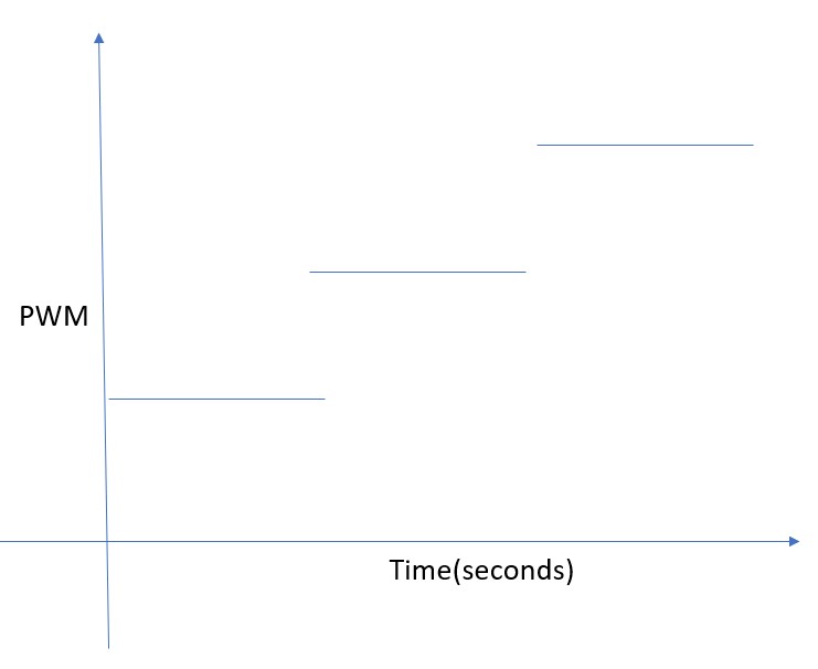

Here is my question. How should I keep a PWM value for a few seconds? or How should I let motor rotates at a constant PWM value for a few seconds just like what it is shown in Fig.1?
