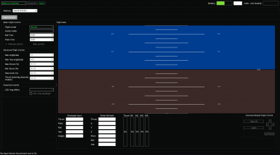

In spite of this, my Crazyflie does not appear as an interface to connect to in the cfclient window. Does anybody know what the cause of this may be? I just received all of the equipment recently and do not believe any of them have been used before.

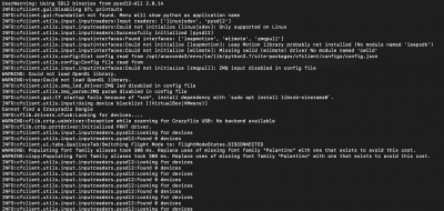

Here is the terminal output when I start the cfclient and search for Crazyflie devices:
Here is what I see in the cfclient window:

This is consistent with the behavior when libusb is not installed.
Assuming you are using homebrew, you can install libusb with:
