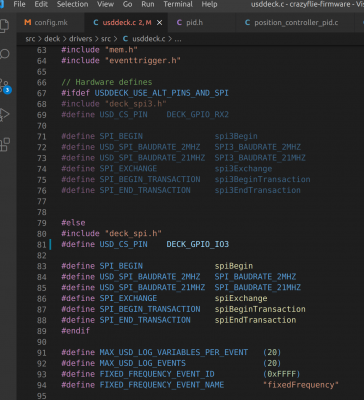

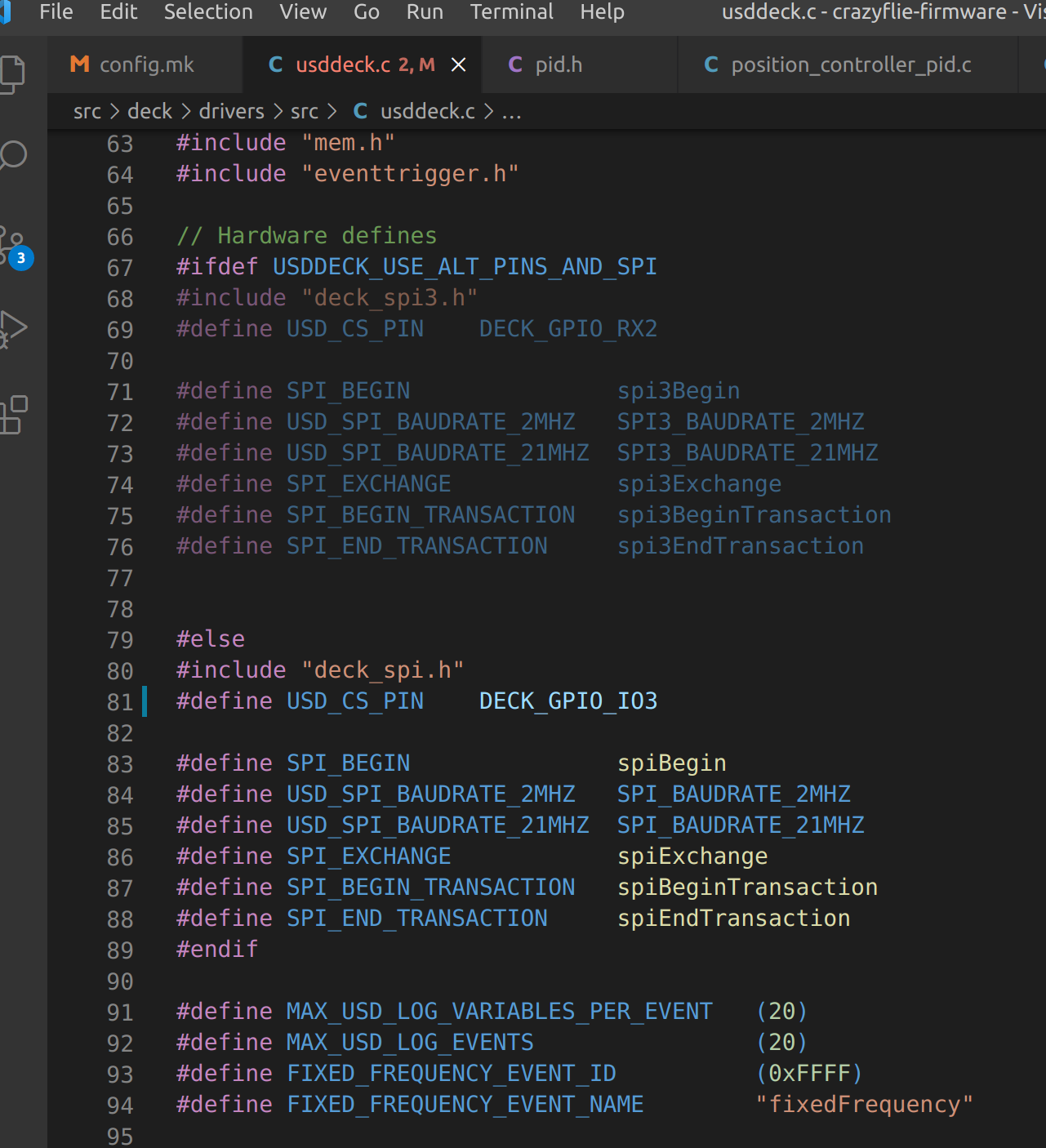

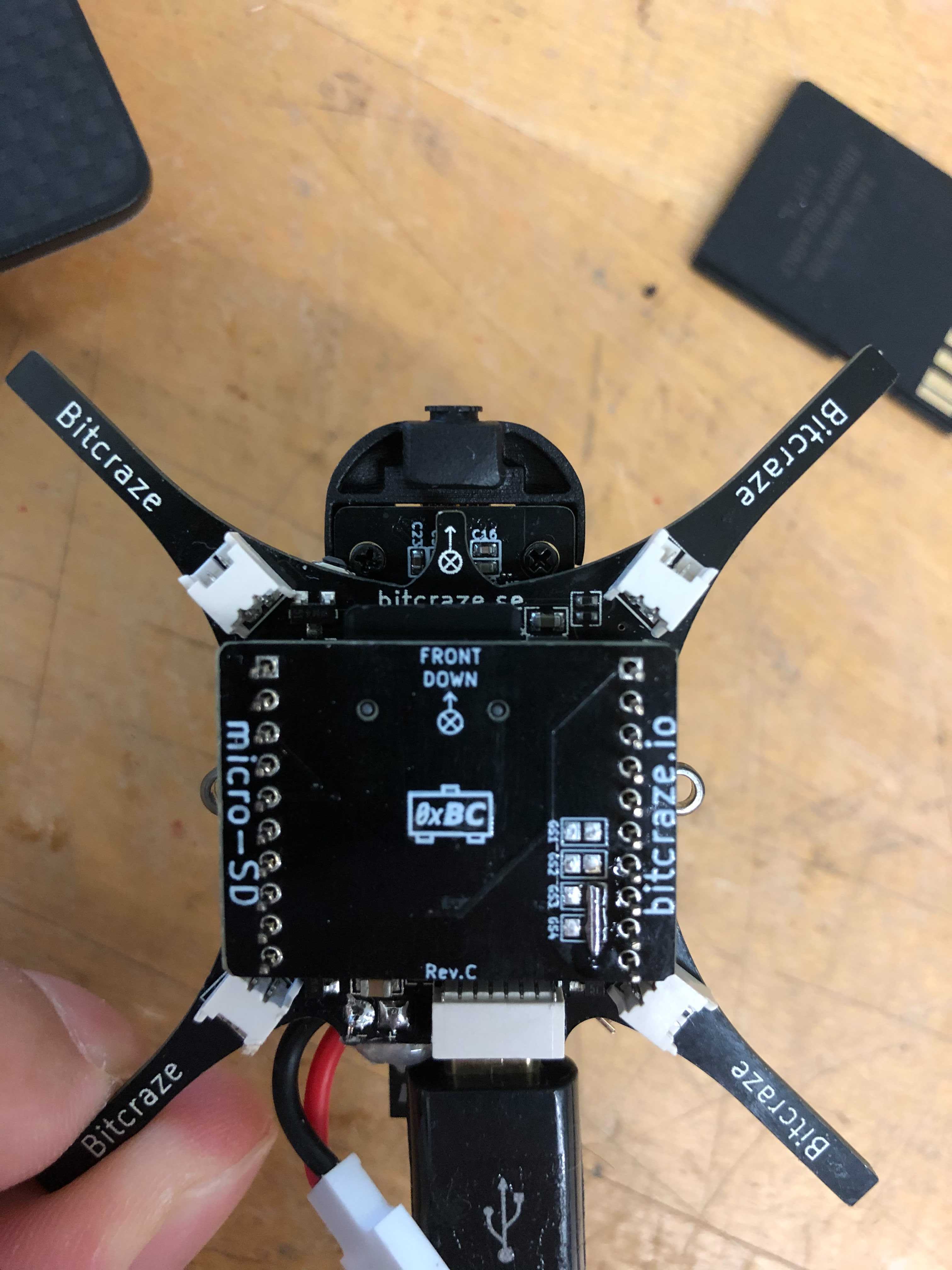

I tested the method you provide but I encountered an error.

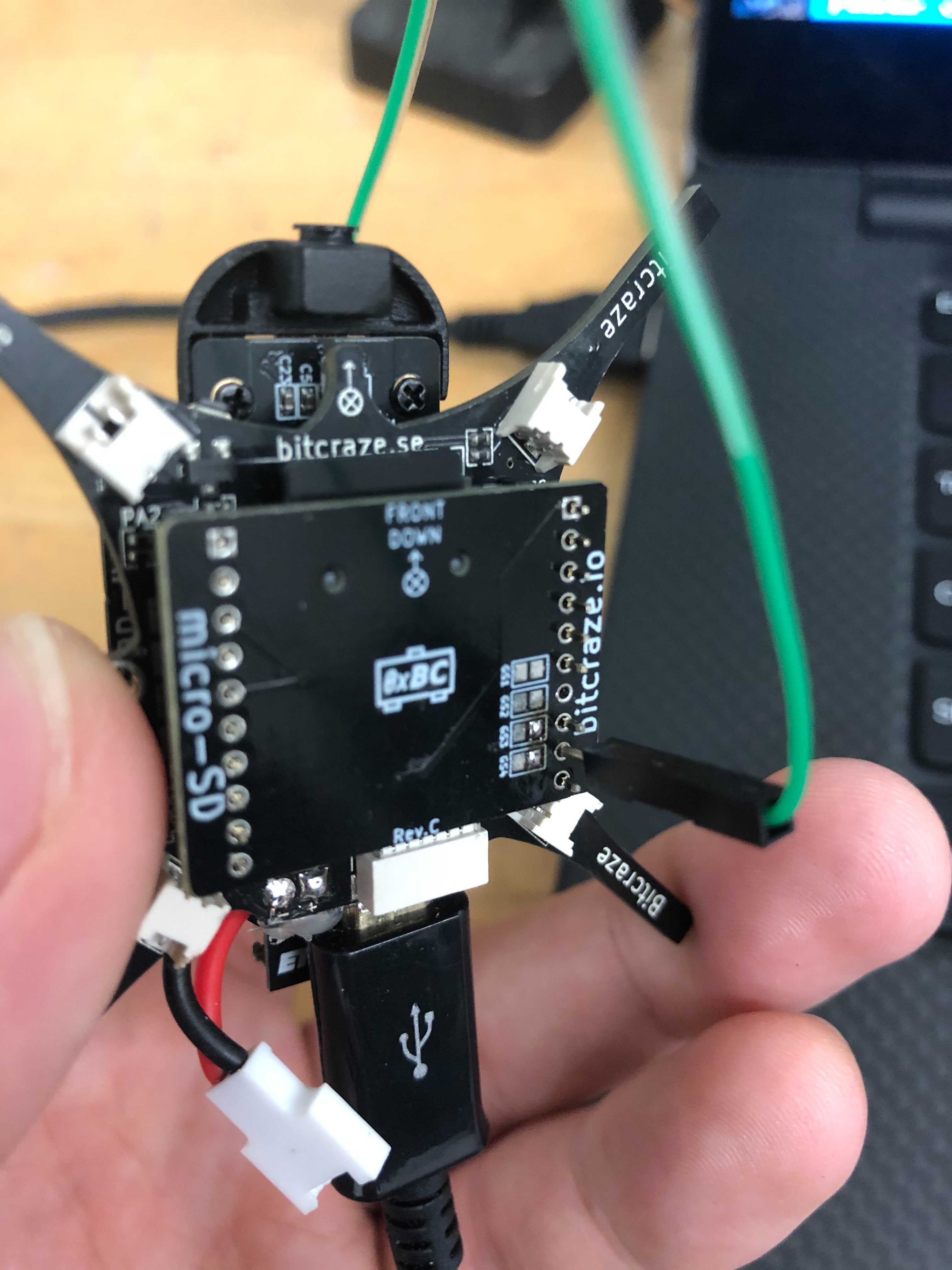

I connected IO3 to IO4 on the sd-card and modified in the usddeck.c to use DECK_GPIO_IO3 (shown in the attached figure). The sd-card can log data with only sd-card deck is connected to CF.
However, I got an error when I connected both AI-deck and sd-card. The error is as follows.
"DECK_INFO: ERROR: Driver Gpio usage conflicts with a previously enumerated deck driver. No decks will be initialized!".
I tried to disconnect the pin of IO4 to SD-card so that IO4 is only used to AI-deck and IO3 is used to sd-card. However, this error still pops up.
I wonder if you can elaborate your solution for this issue.
Thanks!
Wenda

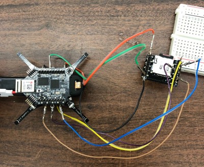

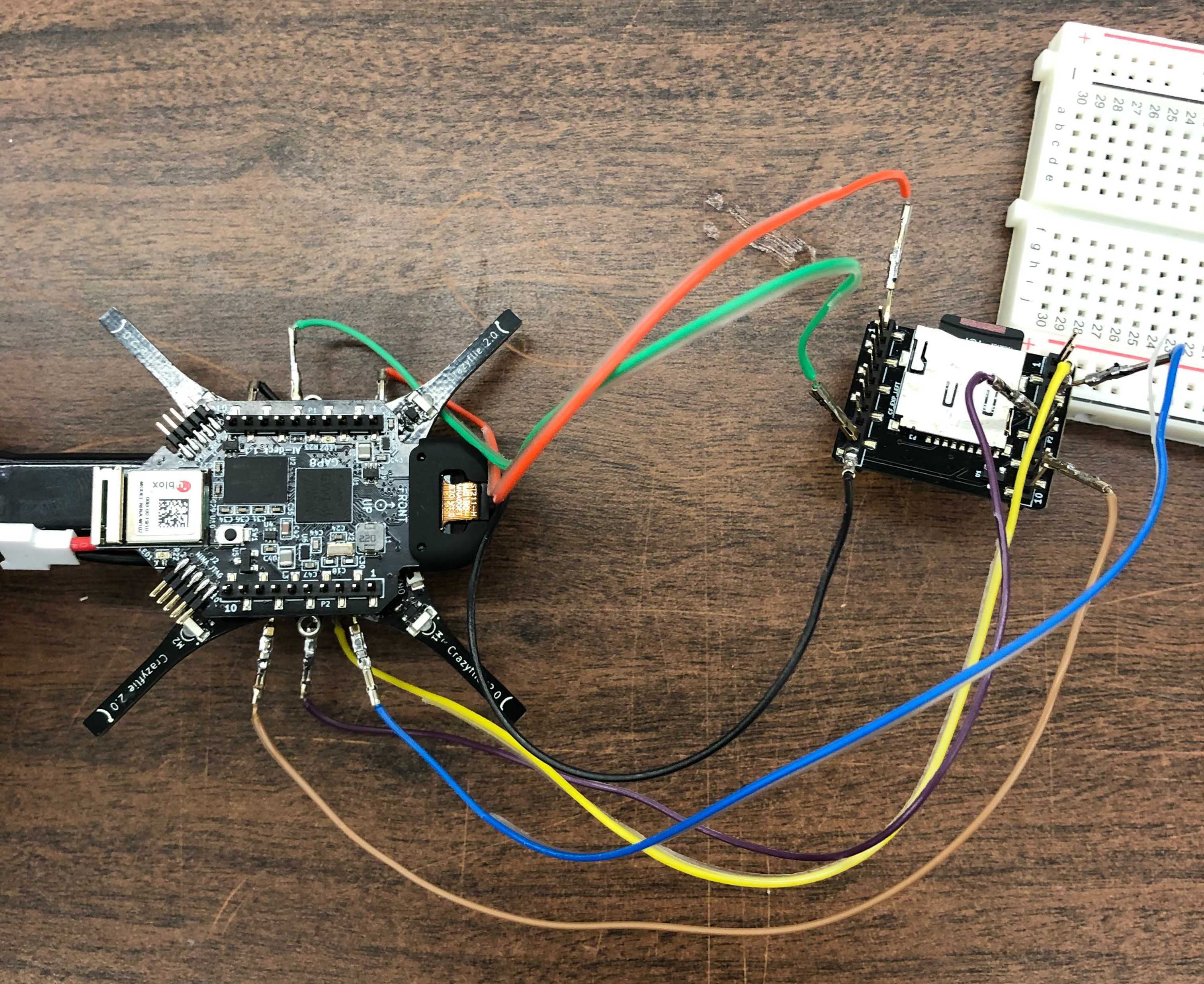

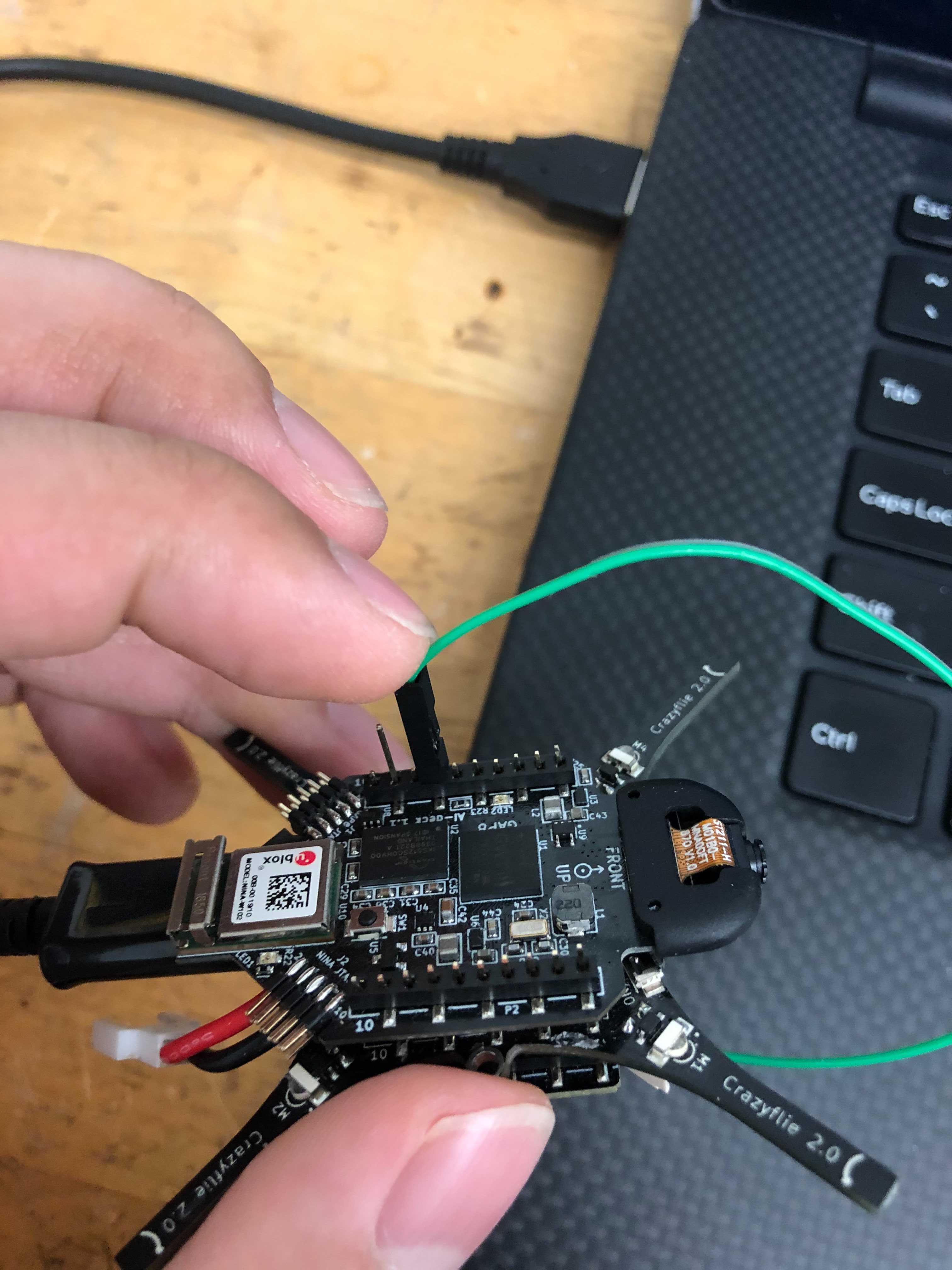

One more update.
I desoldered the IO4 and IO3 on the SD-Card. Instead, I connected the IO2 pin on STM to IO4 pin on SD-card and set the firmware to use IO2 for sd-card CS. Meanwhile, the IO4 pin on CF is only connected to the AI-deck.
The figures are attached.
However, the same problem still came up. Please let me know if I did something wrong.
Thanks
Thanks
