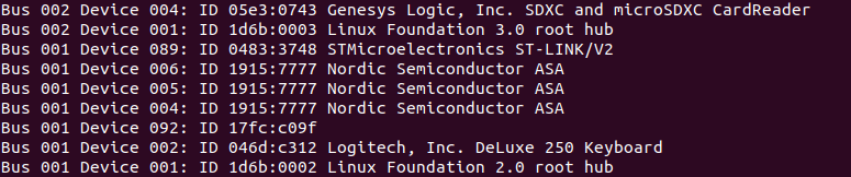

I am using 'Olimex ARM-JTAG-20-10'. I have connected one end of the JTAG (2×5 pin 1.27mm) to the AI deck as shown in the image in the link you sent. The other end of the JTAG (20 pin) is connected to 'ST-LINK/V2, B2018 15'. The ST LINK is connected to the USB port of the computer using a cable. The crazyflie drone is powered using a battery. When the drone is powered on, one green light on AI deck blinks.
When I execute command lsusb on my ubuntu 18.04 machine, I get the below output:
Bus 002 Device 004: ID 05e3:0743 Genesys Logic, Inc. SDXC and microSDXC CardReader
Bus 002 Device 001: ID 1d6b:0003 Linux Foundation 3.0 root hub
Bus 001 Device 089: ID 0483:3748 STMicroelectronics ST-LINK/V2
Bus 001 Device 006: ID 1915:7777 Nordic Semiconductor ASA
Bus 001 Device 005: ID 1915:7777 Nordic Semiconductor ASA
Bus 001 Device 004: ID 1915:7777 Nordic Semiconductor ASA
Bus 001 Device 092: ID 17fc:c09f
Bus 001 Device 002: ID 046d:c312 Logitech, Inc. DeLuxe 250 Keyboard
Bus 001 Device 001: ID 1d6b:0002 Linux Foundation 2.0 root hub

- Posts: 1050
Re: Fot error when running PMSIS helloworld example
So the programmer you use is not the Olimex OpenOCD JTAG ARM-USB-OCD-H as indicated in the error code. You will need to inidicate the right file for you programmer with the define GAPY_OPENOCD_CABLE as indicated in the getting started instructions
However, an STLink v2 will not work on the Gap8 as said here in the jtag instructions, as the stlink can only work on cortex core, which the Gap8 on the aideck is not. You will need to buy the olimex programmer we advise in that documentation. A jlink programmer could work to if you have one, but we have seen problems with it for programming the Nina module.
The bitcraze debug adapter can function the same way as the Olimex ARM-JTAG-20-10 adapter, but since you already have the latter you wouldn't need it.

Hmm this is a bit weird that it wouldn't recognize your programmer. Your log mentioned:
but there is no description of it ? When you do lbusb, is that with the same vid and pid numbers?
We are not sure if this is perhaps an error in the latest version of the gap sdk, so perhaps it would be good to downgrade it and check again. We also have the docker container option that might be handier to switch between gap sdk versions.
Error: unable to open ftdi device with vid 0403, pid 6010, description '*', serial '*' at bus location '*'We are not sure if this is perhaps an error in the latest version of the gap sdk, so perhaps it would be good to downgrade it and check again. We also have the docker container option that might be handier to switch between gap sdk versions.

- Posts: 1050
How to downgrade the SDK is also shown in the same instructions here.
And from the looks of this error seems that there are files missing from the gap8 open ocde:
Have you followed these instructions to installthe gap8 openocd ?
If your environment setup for gap8 development is difficult to do, let me point again to the docker container instructions , which is exactly made for this reason to quickly get started with development.
embedded:startup.tcl:26: Error: Can't find tcl/jtag_boot_entry.tcl

- Posts: 1050
That is usually what you see if the adapter of the jtag lint cable is not correctly connected to the AIdeck. Please see this guide as reference: https://www.bitcraze.io/documentation/r ... ogramming/
Let us know if you are still having problems
