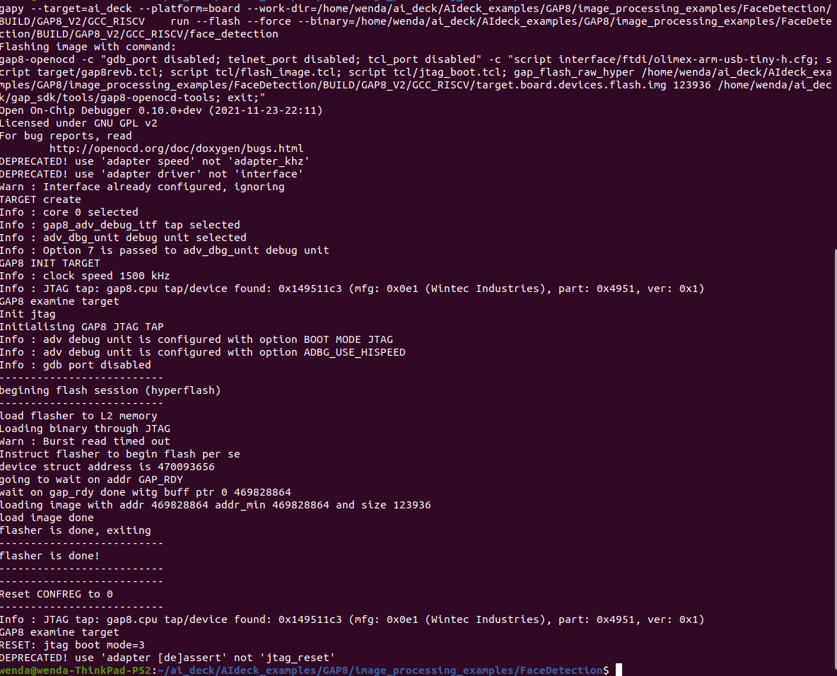

During the flash process, I didn't see any errors in the terminal. (see the attachment)

Hello Wenda,
Yes, the printout in the terminal looks good!
All I can think of to verify your code is running is through some peripheral (LED, streaming over WIFI, communicating over UART with STM32).
I do believe you have to reboot your GAP8 chip before it actually runs flashed code. (have you tried turning it off and on again)
Also, about the commands for flashing, I recommend running "make clean all flash", this first cleans the project (you don't always have to do this, but sometimes it's better to be safe than sorry), then actually compiles it (which doesn't happen when you "make image" or just "make flash", then flashes it.
