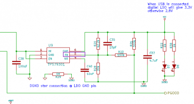

This sounds like the voltage regulator U9 has broken. Can be fixed by replacing it. See this thread.

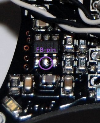

What sets the output voltage is the feedback programmed voltage since these are adjustable regulators. You can check that the feedback voltage is healthy by measuring it, which is pin 5. Be careful not to short against any of the other pins as you have to do this while the board is powered. The voltage on the feedback pin should be close to 1.22V.
