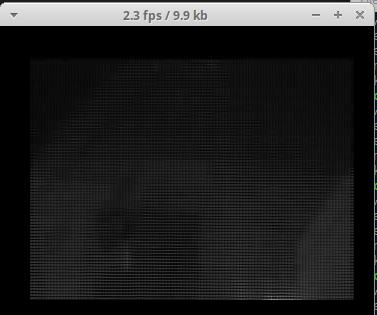

How to save color images when using Crazyradio
I want to know how I can save color images when using Crazyradio. I already switched to a color camera, and I flashed the test_camera code to GAP8. However, when I open viewer.py, the images have gridlines just like in this post (viewtopic.php?p=23386&hilit=color#p23386). I want to save the color images into .jpg format. Could you please give me some hints? Thank you!

Re: How to save color images when using Crazyradio
Since the streamed image is JPEG compressed I would recommend doing the demosaicing on the GAP8, so before streaming. There are examples of demosaicing in the AIdeck_examples repository, for example in the camera test. The demosaicing function is found in the img_proc files. Be aware of the fact that the output of this particular demosaicing function has the same spatial resolution as the input, but three times the channels (grayscale -> RGB), resulting in an image buffer of three times the size. You will have to change the frame_streamer_conf to accomodate for this tripling in streamed data, I believe by changing the depth to 3.
Since the images are JPEG compressed, the viewer.py can automatically detect when it received the full image. The fact that we are now dealing with a color image should also be encoded in the header of the JPEG file, so perhaps it picks up on this automatically. I can help you debug this when you get to this point!
As a sidenote, in the WiFi streamer example, you actually connect to a WiFi hotspot running on the ESP32 NINA (on the AI-deck), the Crazyradio does not come into play here.
@gemenerik, I tried to modify the code, but the viewer.py shows strange gray images. The color mode of the color image is RGB565. I'm not sure if it's correct. I also changed the streamer_conf.depth to 3 as you said. Could you help me? Thank you.
Here is my code:
Here is my code:

Hi Noah,
With the buffer format in RGB565 you will want the image to stream to be in that same format. The default demosaicking function creates RGB888 images. I made some changes to my demosaicking function, and managed to successfully save the RGB565 image with WriteImageToFile. However, the Python viewer still interprets the images as grayscale. Fixing that is a bit less trivial than I thought. To be honest, I'm not sure where in the pipeline it goes wrong anymore; perhaps the frame_streamer on the GAP8 does not even support RGB. I'll try to get some help from those who set up the initial streamer.
There is some reference to color encoding in the gap_sdk. I could not get that to work though. We are now investigating streaming raw image data, instead. We found that JPEG encoding takes a long time anyways, so it might even improve performance. Especially if you do the demosaicking off-board.

Sorry for the late reply but it looked like this was a difficult question to answer. This actually means that the Nina wifi module's firmware needs to be very heavily adjusted... we might think of a solution for this one, e but it's not quite ready to share, so please keep an eye on the blogposts, as we will share an guide on how to do this once we got something running.
