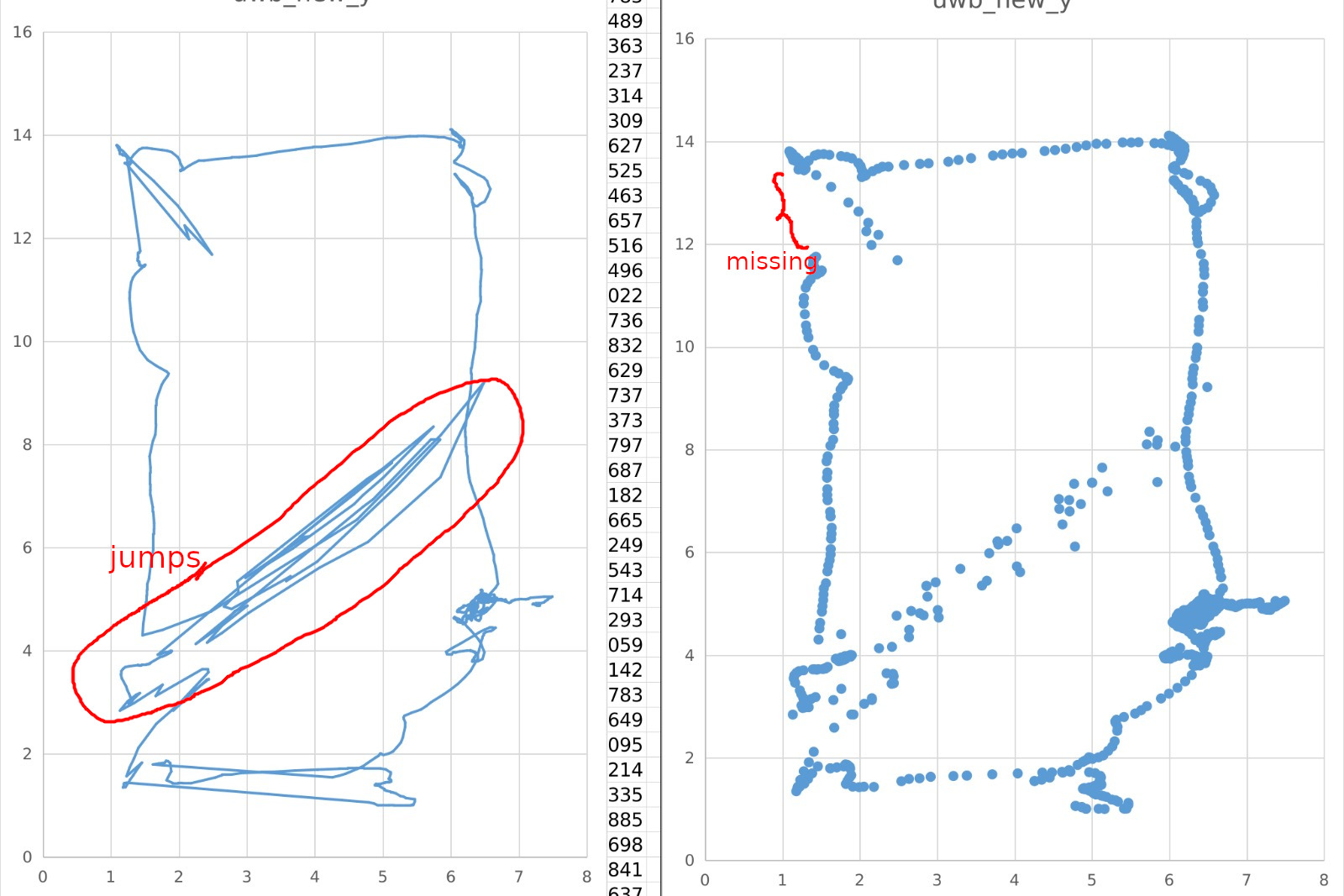

Our setup involves a larger drone with a Crazyflie 2.1 strapped on top for position estimation in combination with 8 LPS nodes. When flying a rectangle in XY, the position estimate seems to be correct most of the time, however large jumps in position occur in one of the corners, and sometimes we don't seem to receive position data from the Crazyflie. Both can be seen in the image below.
Do you have any idea what could cause this behaviour?
Thanks!
Jessse
Big jumps in LPS position in one spot

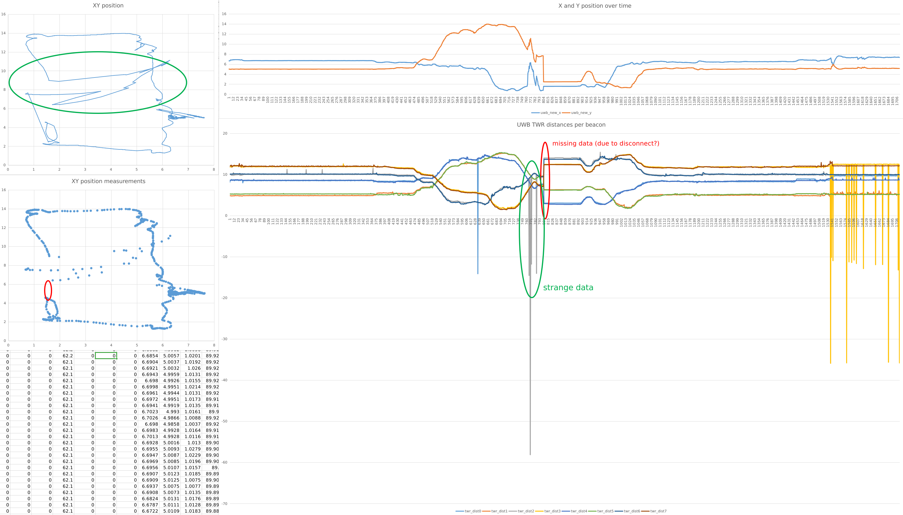

I have more data from another flight, also with these strange jumps and missing data. But now, we also logged the individual TWR distances. Also, we observed that a disconnect happened during the flight, which could explain the missing data? Please find the plots below. Thanks!

Yes, the anchors are in the corners of the flight space, which is 8x16x3 (xyz) meters. We did two flights where the drone was controlled manually (data shown before), and it seems to be roughly the same spot. The anchor distance logging also shows that in both cases, anchor 2 gives weird measurements. Anchor 2 is located in the lower plane on the top right corner of the flight space (8, 16, 0), which seems furthest away from the spot where the corrupt/missing data is.
We think the missing data from all anchors at the same time can be explained by a disconnect between crazyflie and crazyradio. Because our own loop has blocking reconnect code, it doesn't continue logging, but because we fly manually and the crazyflie is strapped to another drone, the flight continues. As soon as it reconnects, it seems to the logger as if the drone has "teleported". Does this make sense?
Also, am I correct in assuming that TWR doesn't have outlier rejection, hence the large influence of the corrupt measurements on the position estimate? Maybe we would be better off with TDoA3, which does have outlier rejection?

One thing I'm curious about is the graph with distances to the anchors. The weird values you get seems to be negative which does not make sense from a physical point of view. Are you logging the ranging.distance0 to ranging.distance7 log variables?
A negative value could indicate that there might be some sort of bug in the distance calculation when reception is bad?
It would be easy to filter out any negative values in the outlier rejection which would maybe be an interesting experiment?
I also see that you get negative values for the blue, gray and orange anchors, does this correspond the anchors that are furthest away?
