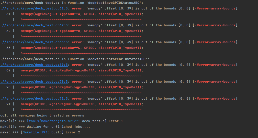

I followed the steps outlined here to build the stm32 firmware on Manjaro.
However, when I run make, I get the errors in the attached screenshot. I have not modified the source code yet.
Any help would be greatly appreciated!

Hi comathi!
Some questions!
  1. Could you perhaps paste or update the full output of the make command?
  2. Could you tell us the output of $ arm-none-eabi-gcc --version
Thanks Jonas

And the following is the full output of the make command:

.//src/deck/core/deck_test.c: In function 'decktestSaveGPIOStatesABC':
.//src/deck/core/deck_test.c:61:3: error: 'memcpy' offset [0, 39] is out of the bounds [0, 0] [-Werror=array-bounds]
   61 |   memcpy(&gpioRegBuf->gpioBuffA, GPIOA, sizeof(GPIO_TypeDef));
.//src/deck/core/deck_test.c:62:3: error: 'memcpy' offset [0, 39] is out of the bounds [0, 0] [-Werror=array-bounds]
   62 |   memcpy(&gpioRegBuf->gpioBuffB, GPIOB, sizeof(GPIO_TypeDef));
.//src/deck/core/deck_test.c:63:3: error: 'memcpy' offset [0, 39] is out of the bounds [0, 0] [-Werror=array-bounds]
   63 |   memcpy(&gpioRegBuf->gpioBuffC, GPIOC, sizeof(GPIO_TypeDef));
.//src/deck/core/deck_test.c: In function 'decktestRestoreGPIOStatesABC':
.//src/deck/core/deck_test.c:69:3: error: 'memcpy' offset [0, 39] is out of the bounds [0, 0] [-Werror=array-bounds]
   69 |   memcpy(GPIOA, &gpioRegBuf->gpioBuffA, sizeof(GPIO_TypeDef));
.//src/deck/core/deck_test.c:70:3: error: 'memcpy' offset [0, 39] is out of the bounds [0, 0] [-Werror=array-bounds]
   70 |   memcpy(GPIOB, &gpioRegBuf->gpioBuffB, sizeof(GPIO_TypeDef));
.//src/deck/core/deck_test.c:71:3: error: 'memcpy' offset [0, 39] is out of the bounds [0, 0] [-Werror=array-bounds]
   71 |   memcpy(GPIOC, &gpioRegBuf->gpioBuffC, sizeof(GPIO_TypeDef));
  CC    deck_digital.o
cc1: all warnings being treated as errors
  CC    deck_analog.o
make[1]: *** [tools/make/targets.mk:27: deck_test.o] Error 1
make[1]: *** Waiting for unfinished jobs....
make: *** [Makefile:393: build] Error 2

Hi comathi!
I think the issue is that you have a quite new GCC version, that has added a new warning. (-Werror=array-bounds).
You could try to add the following line to the Makefile:
CFLAGS += -Wno-array-bounds
You can look for similar lines!
