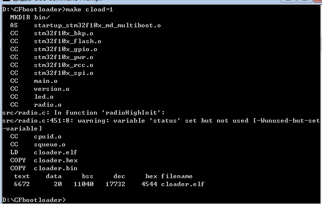

I give my CF burn BOOTLOADER firmware (CF's board red led have every 1 second flashing), but I can't pass the CLIENT " initate bootloader cold boot " to connect to the CF to upgrade the application. .........Client display :" status : connection timeout "
INFO: cfclient. UI. Dialogs. Bootloader: Connected in coldboot mode failed
When I connect the CF has been discovered in the client, as follows
INFO: cflib CRTP. Radiodriver: v0.52 dongle with serial N/A found
Whether the link went wrong Or CF work in the bootloader mode ? ?
The following is the screenshots I compile crazyflie bootloader
programming CF BOOTLOADER
Still unable to connect successfully, but there is a new found that want to correct my problem, CF red leds and green leds packed in CF BOOLLOADER after startup, flashing in them! (1 hz)... According to the CF related LED instructions, whether my CF in the charging mode?
