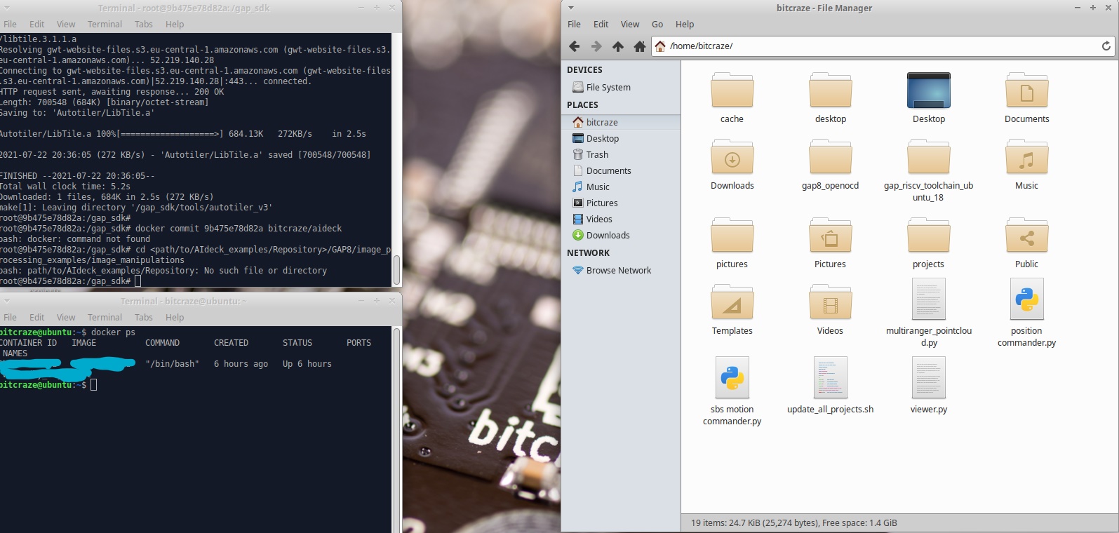

So I followed this website https://www.bitcraze.io/documentation/r ... ker-gap8/ , but I am not able to run any example. I might be missing something to run but I am not sure what. I also went through this https://www.bitcraze.io/documentation/r ... tection/ one before the gap 8 docker.
For the first link I attached I got stuck in the "Running an Example"

Hi. Let's do one thing at the time... so let's fix your docker issue first.
So your screenshot is showing that you do the
within the bitcraze/aideck container itself. That is not what the instructions are indicating. You are supposed to do the commit in the same terminal where you did the 'docker ps' command, so in a seperate terminal outside of the docker container.

I did it in a separate terminal but I closed it, since it was just one line of code.

Oke great, I saw it in the container file so I thought that it how it went.
Now you can close the container again with 'exit' and use the 'running an example' subtitle of the docker instructions, like face detection example. You go to the folder where the Makefile exist of the example and then copy and run the docker command.

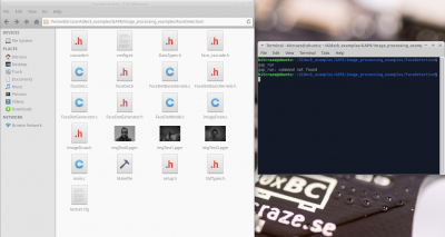

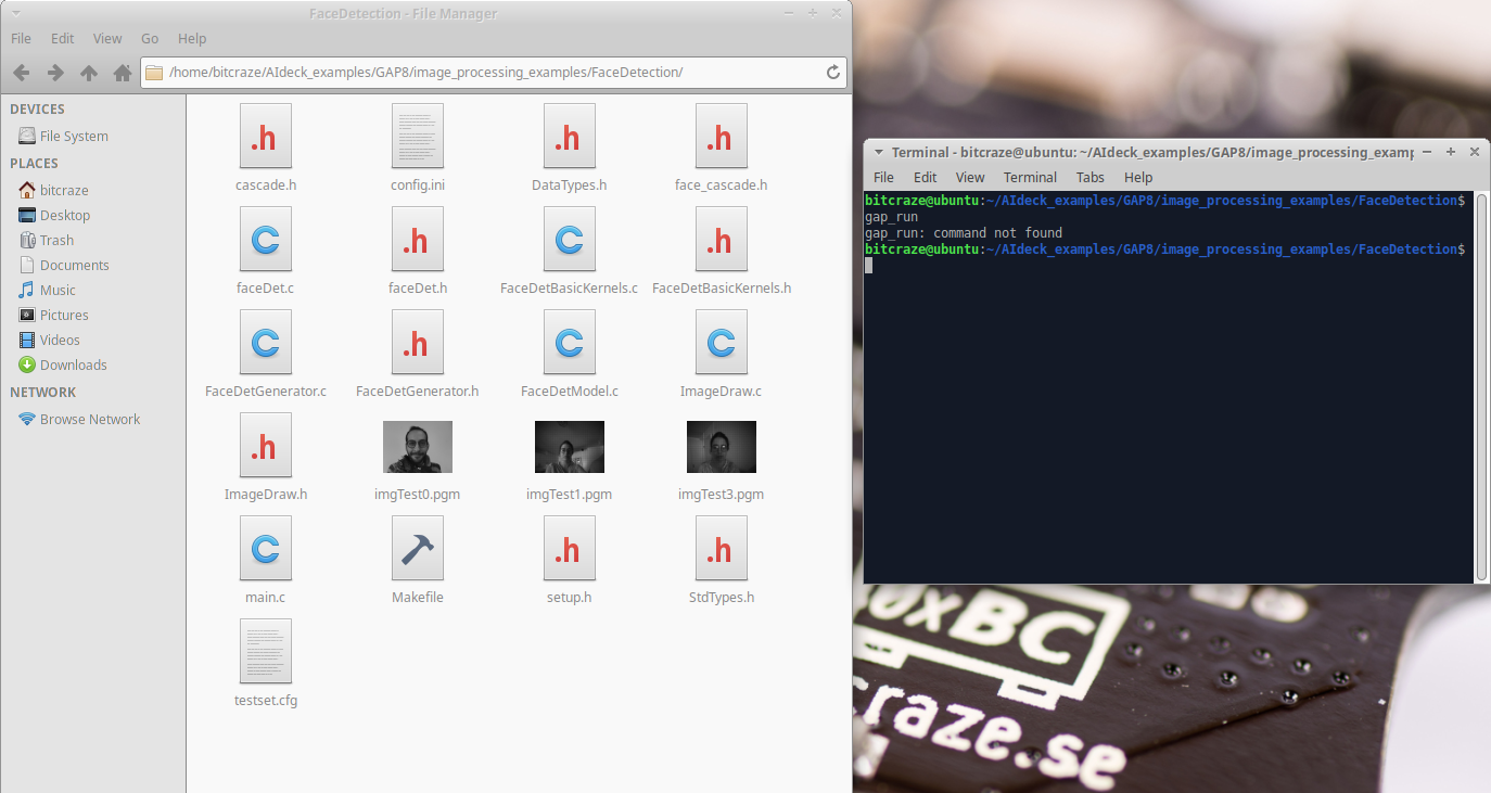

That’s where I have problems, where should the make file be located at ? I looked for the AI deck examples folder but I can’t find it in the virtual machine.
- Posts: 1050
Re: Face detection
It's not by standard in the bitcraze virtual machine. You will need git clone this repository to it first: https://github.com/bitcraze/AIdeck_examples

How can I run the face detection code?
- Posts: 1050
Re: Face detection
The gap_run function will only work on the aideck VM provided for the AIdeck workshop. in your case, you will need to follow the exact instructions of the docker instructions of running an example:
Make sure that your debugger is selected in your VM and that the right .cfg is also in the same command line as well.
If that works, you can use the above line to create an 'gap_run' alias in your ~/.bashrc file
docker run --rm -it -v $PWD:/module/data/ --device /dev/ttyUSB0 --privileged -P bitcraze/aideck /bin/bash -c 'export GAPY_OPENOCD_CABLE=interface/ftdi/olimex-arm-usb-tiny-h.cfg; source /gap_sdk/configs/ai_deck.sh; cd /module/data/; make clean all run'If that works, you can use the above line to create an 'gap_run' alias in your ~/.bashrc file
