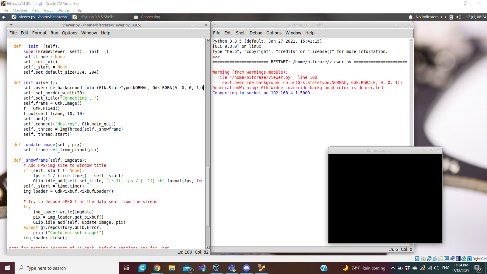

I am following https://www.bitcraze.io/documentation/r ... ed/tryout/ and I am currently stuck when I am running the example. I might have done something wrong.
Viewer.py error

So let me just ask you a couple of questions first:
- Which AIdeck do you have ? the 1.0 or the 1.1 ?
- Have you flashed anything on the aideck yet, or have you just gotten the aideck new?
- In that screenshot, are you currently connected through your computer with 'Bitcraze AI-deck Example' through WiFi?
- The NINA Led should be flashing quicker if you are connected to the viewer. Are you observing this on your aideck?

Re: Viewer.py error
I just connected it through wifi and it worked.
Is it normal if the new window that appears is "blinking". I can see the image, then it becomes all black and then I can see the image again.
- Posts: 1050
Re: Viewer.py error
Could you pull the latest changes of the AIdeck_example repo? There are some changes that might fix it a little.
