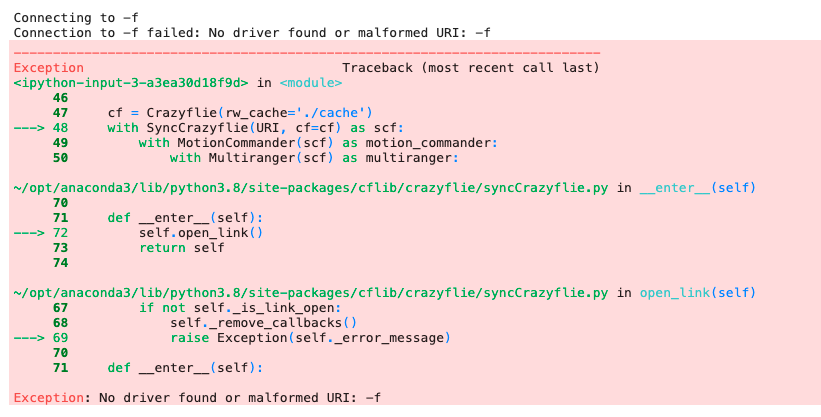

When trying to fly a Crazyflie using the multiranger_push.py code (found here https://github.com/bitcraze/crazyflie-l ... er_push.py), the code prints "Connecting to -f", followed by "Connection to -f failed: No driver found or malformed URI: -f". This is peculiar, as I am able to get other code to run smoothly, but have problems only with this particular python file.
Is there anything that might be causing this? Perhaps an outdated repository, or a library I've forgotten to install? Thanks for any help!

In addition to the other errors from before, this gives
['/Users/david/opt/anaconda3/lib/python3.8/site-packages/ipykernel_launcher.py', '-f', '/Users/david/Library/Jupyter/runtime/kernel-ece51ab0-1a51-4425-a89b-3b604e34c2cb.json'] - radio://0/100/2M/E7E7E7E702

Issue solved: Simply removing this section:
URI = uri_helper.uri_from_env(default='radio://0/100/2M/E7E7E7E704')
if len(sys.argv) > 1:
URI = sys.argv[1]
And replacing it with:
URI = 'radio://0/100/2M/E7E7E7E704'
or another equivalent URI allows the code to run. Perhaps this suggests a problem with the uri_helper code? But easy to work around.

Yes that is how the example used to be... but the urihelper was supposed to be better as it was harmonizing the URI handling for all the examples (see this PR).
I've made an issue to make us remember to thoroughly test this again: https://github.com/bitcraze/crazyflie-l ... issues/251
