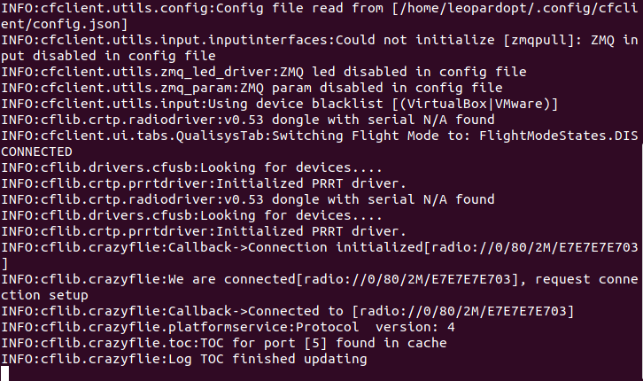

Hi Jonas,
Thank you for the response. I have two trials in which one is with 1 V1 base station and the other with two. Here are the pictures of both the terminal and the drone with basestations:
Trial 1: 2 V1 basestations: (I could not add the picture of drone to this but as mentioned the drone's yellow light is on while the M1 LED blinks red multiple times in short time) [The console never adds anything else after "it finished updating..." even if I wait for a long time]
Trial 2: 1 V1 basestation: (Once again drone picture could not be attached so the drone's deck LED turns green due to previous setup and M1 LED blinks normally 1 time in longer periods)
Please let me know if there is anything that can be done about the deck and I am not sure if this is the issue of the drone or the lighthouse deck. I am still confused why it doesn't want to work with 2 V1 base stations.

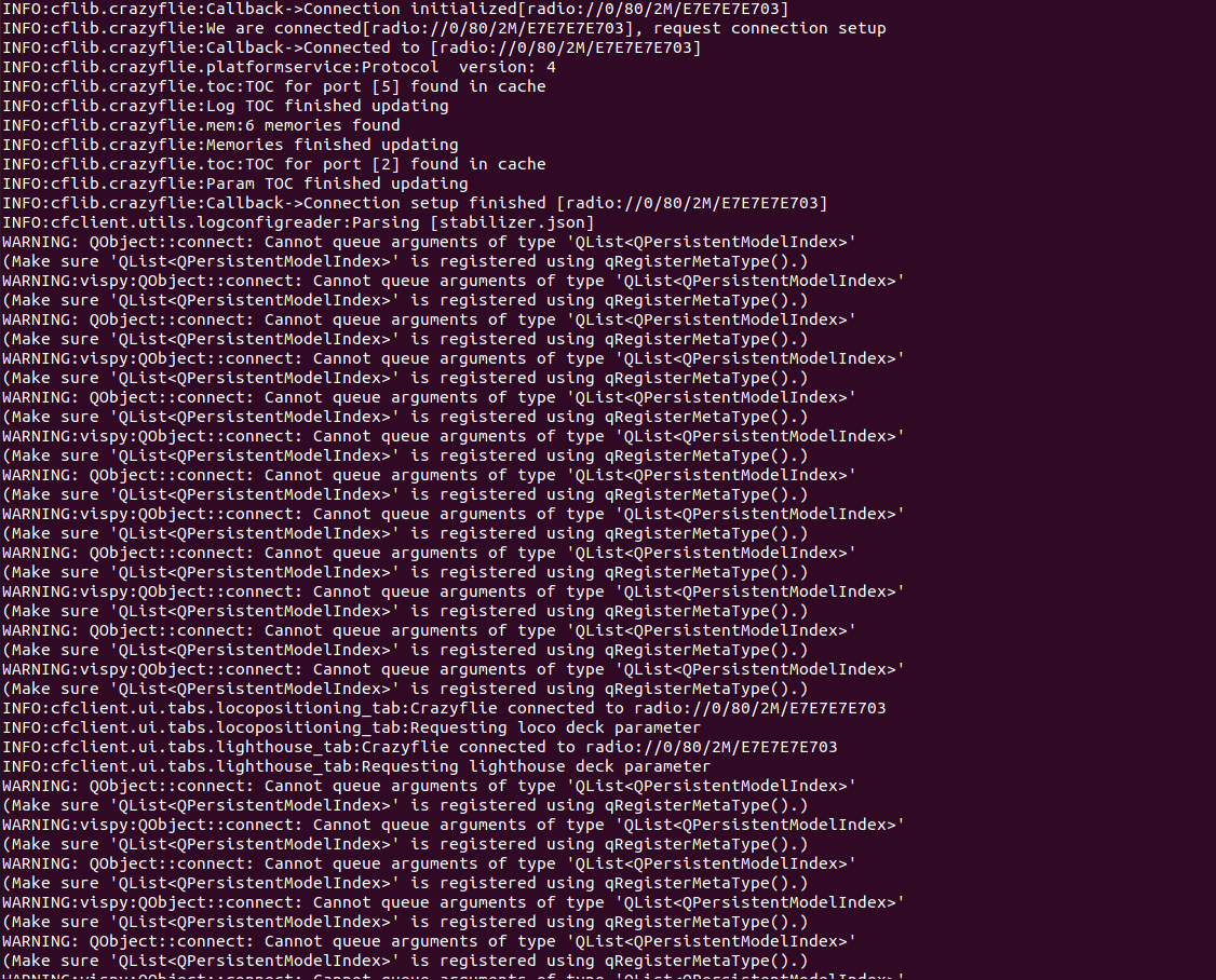

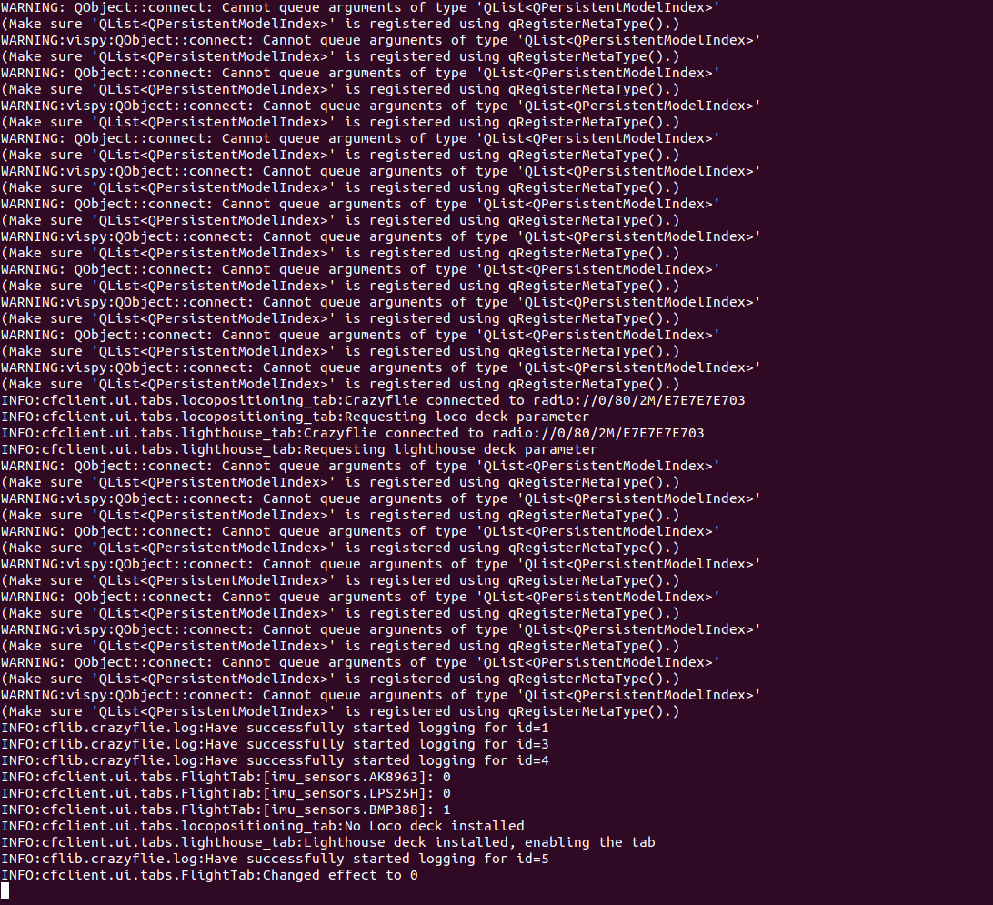

Re: Lighthouse Deck Not Responsive
Sorry for the delay. I forgot that there was a "console" tab on cfclient. Thank you for mentioning it. Below are the attachments of screenshots:
Trial with 2 sensors (V1): Trial with 1 sensor (V1) on A channel: I can see that it says something in math.h has failed and then it just says that it has failed but not sure if there is a way to fix it. For 1 sensor, I have to set it to A channel in order for crazyflie to receive the sweeping angles.

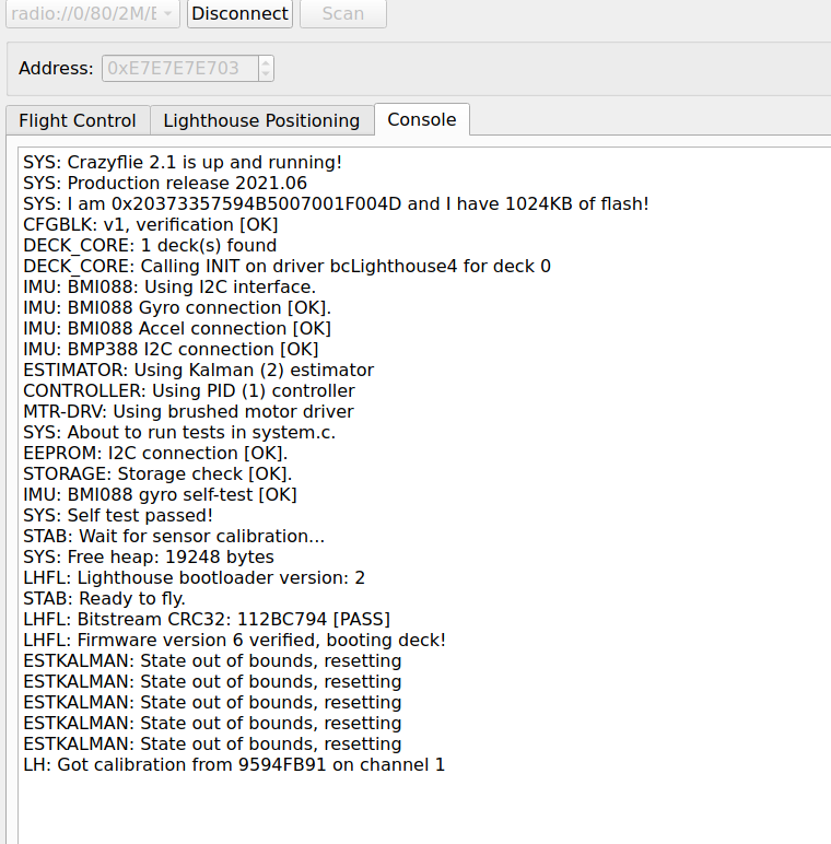

- Posts: 1050
Thanks!
So your lighthouse deck has been flashed correctly, as it is saying it has version 6, which is indeed the latest version of the LH deck firmware.
I've tried to also use the V1 basestations on exactly the same firmware as you, but I don't see what you are observing... It's all working for me.
So you mentioned that you put one basestation to A, but did you also put the second basestation to 'b' like told in the instructions of the tutorial?
What you can also try, is to switch the system type in the lighthouse tab from V2 and than back to V1 (so that all the calibration data and geometry data is removed), wait for the calibration data and do the geometry estimation again. Let us know if this worked or not!
