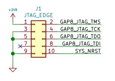

It is good you got the ESP32 programmed back. I'm not sure why the GAP8 is not responding anymore though. After you were able to flash the ESP32 with the wifi streamer example is the LED1 blinking then?
For the GAP8 I tired it with our jlink and got this output with the wifi streamer example:
What is a bit strange is that you get VTarget 3.287V but it should be around 2.8V. I'm suspecting some contact problem. Is the cable glitching or the connector?

Do you mean that I've flash the ESP32 successfully? I'm wondering maybe problem occurs because I'm using jlink v11 instead of jlink v8. My another AI-deck which is not broken feeds back the same high voltage, Which is around 3.3v, but I can flash code to it easily.

I don't know if the 3.3v means anything but possibly the jlink can supply 3.3V? If you have a multimeter can you measure the GAP8 JTAG connector when the AI-deck is powered? You should measure pin 1 and 9 as per the image. If you can measure it with and without the JTAG cable connected that might tell us something. Have you ever manged to flash the GAP8 successfully? It worked before you managed to flash the ESP32 with the GAP8 FW right?
After flashing the ESP32 is the LED1 blinking. I mean does it seam to be running?

Indeed I have used the jtag v11 to supply 3.3V power. Now I have changed Supply voltage to 2.8V. Again I successfully flash the NINA and indeed I see the LED1 is flashing. Then I tried to flsh code to the GAP8. The terminal is shown below. Still I can't download code to GAP8, even a single HelloWorld. Is that possible that the GAP8 chip is broken.
