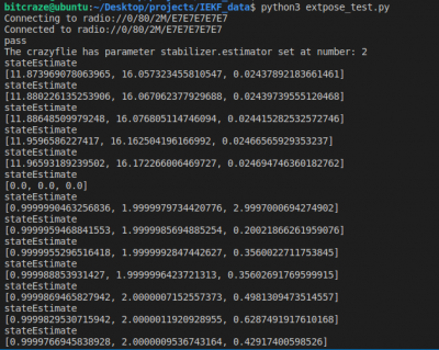

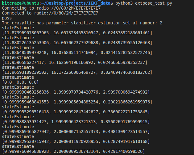

The results(see attached picture 1) shows that I can only set the 'stabilizer.estimator'=1, once I set the 'stabilizer.estimator'=2, my callback function will not have any response. I think this is the reason why my estimator doesn't work, but I don't understand why this will happen?
Another interesting test that I have done is. First of all, I take off the multi-ranger deck but I didn't take off the optical flow v2 deck. Under this case, The results(see attached picture 2) shows that I can only set the 'stabilizer.estimator'=2, once I set the 'stabilizer.estimator'=1, my callback function will not have any response. Also, the stateEstimate.x and stateEstimate.y is the data that we send, but stateEstimate.z is not(seems like the data estimated from optical flow v2 deck).

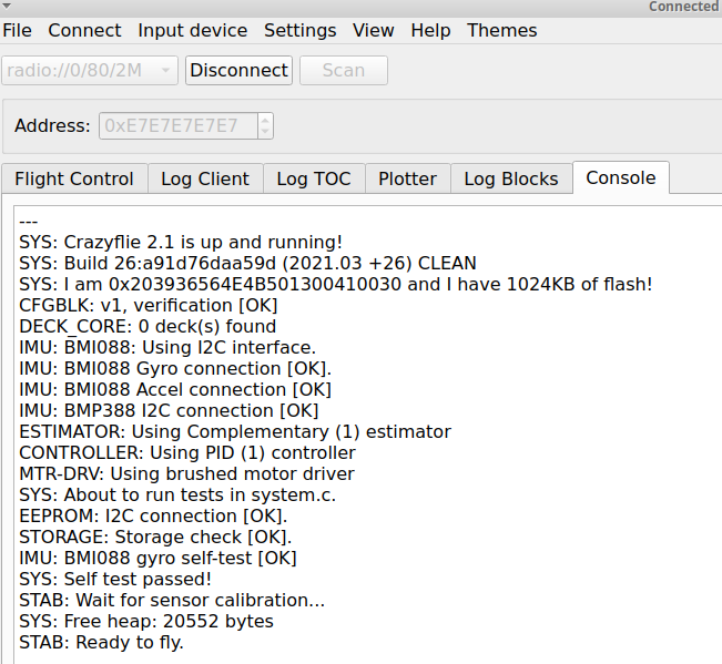

I do flash a new firmware code by using the CFclient, the console info is attached picture3. Looking forward to your reply!
Posts: 1050
Re: How to set the default filter be kalman filter?
Post by kimberly »
In the console screenprint, it seems that you are not on the latest master or the latest release of the crazyflie firmware. So let's see first if that is the cause.
Go ahead and update to the latest clean release (2021.03) via these instructions.
After that (let's do without any decks), you can change stabilizer.estimator to 2 in the parameter tab. Then to double check if this worked, check if you are getting the following in the console tab:
Let us know if this is successful!
