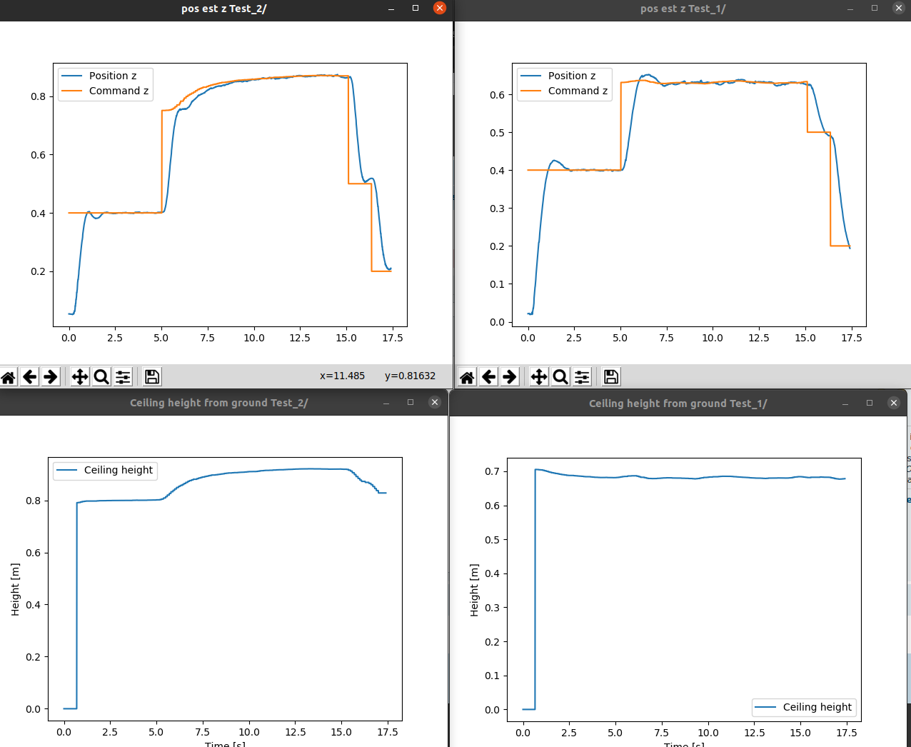

The problem still exists, and i did the battery test after updating the client. I am running the latest firmware and the problem is still there. When I put in a charged battery the first flight is okay as seen in the right figures. The flight is commanded to go towards 0.4 and afterwards 5cm measured from the ceiling, which is also estimated at the correc +/- 70cm. But when I switch the cf off and on, without changing anything and running the same flight code. The flight is different as seen on the left figures, the 0.4 height command is still fine, but afterwards the ceiling distance of 5cm is reached but the height it thinks it is flying on is different as well as the ceiling height estimation, which now suddenly became 80+ cm.

In the graphs the command z behaves very differently on the left side. It slowly rises after reaching 70cm.

In the left plot the commended z is rising, do you know why that is?

The way I command the crazyflie is the following.
When the upper sensor senses a distance of less than 0.5 meters my ceiling distance estimation is switched on. This estimation is as follows it takes the measurement from the upper sensor when switched on and adds the displacement measured by the state z each time step. When the upper sensor gets a new measurement this estimate is corrected using a gain.
To estimate the total heigth from ground to ceiling I add the state_z + ceiling estimate. This value is send to the python code and from there I can command the crazyflie to fly a certain distance from the ceiling.
Somehow with the second flight it senses the ceiling to be at 0.8 meters, using the state and the ceiling estimate. But when it reaches the setpoint where it should fly at the desired distance from the ceiling it measures that the ceiling is still further away then wanted. Thus it measures that the ceiling is higher than it thought and thus gets send a new setpoint making it rise until all measurements stabilize.
This is weird as in one flight it measures the height correct at 0.7 meters and flies "perfectly" towards the desired height. Then in the second flight the ceiling is higher and when it climbs towards it this height keeps increasing.
With the position_z being solely the state estimate z from the kalman filter. So the height from the kalman filter is different between the 2 flights even though the surroundings did not change.
