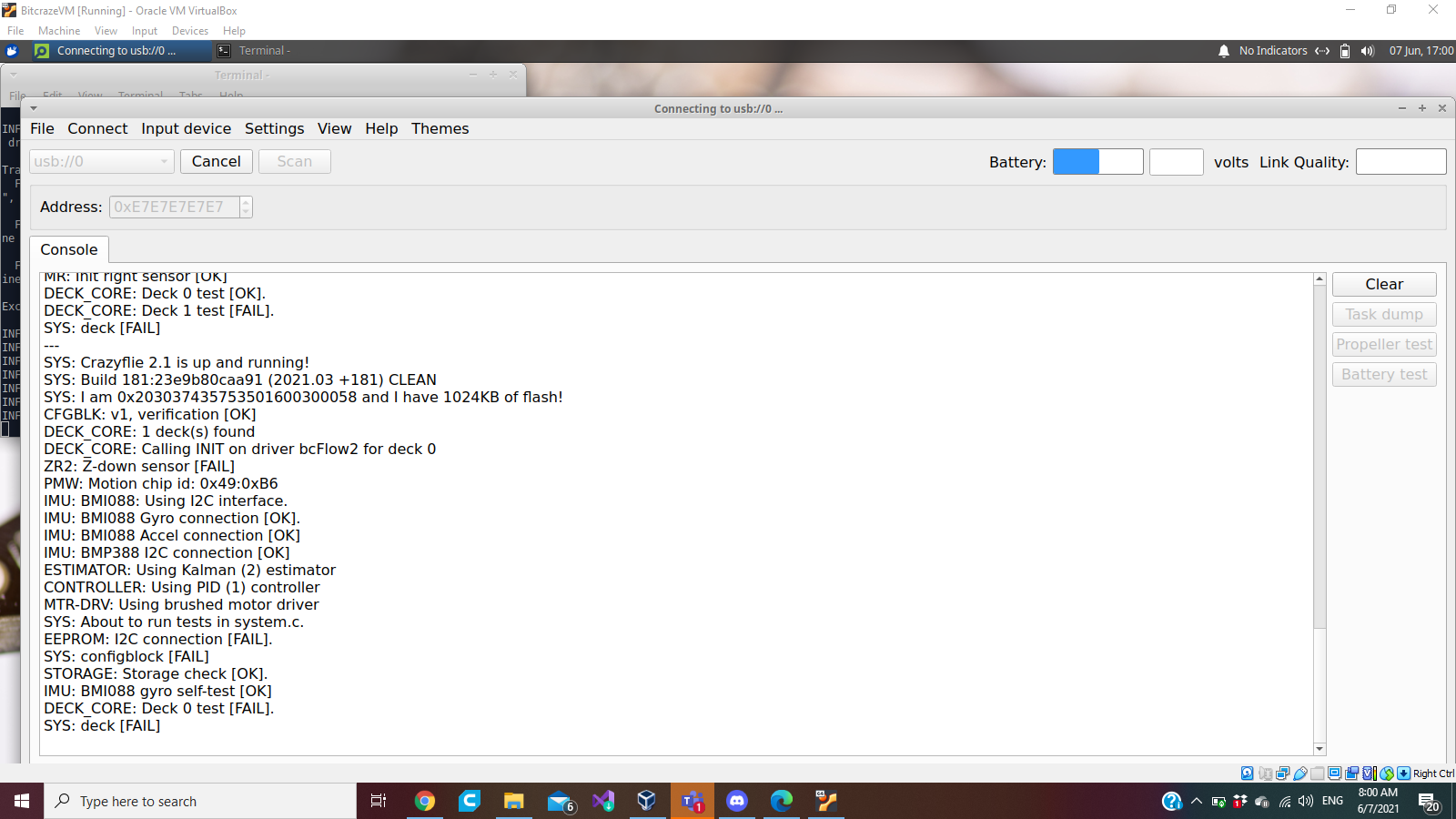

I attached an image with only the flow deck v2.

Tobias was referring to the latest release of the Crazyfle firmware (https://github.com/bitcraze/crazyflie-firmware/releases). It looks like you are using a later version compiled from source code and it would be interesting to see if the problem also exists with the 2021.03 to rule out software problems.The latest release 2021.03
The easiest way to flash the 2021.03 version to your Crazyflie is to use the bootloader option in the python client, see https://www.bitcraze.io/documentation/r ... re-upgrade.

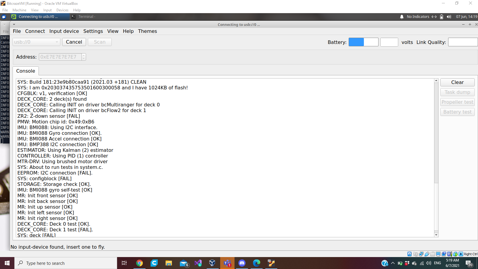

I took off the flow deck v2 and then did the update. Did I had to leave it on or was is suppose to be without decks?
I am still have some errors, but not as much as before.
