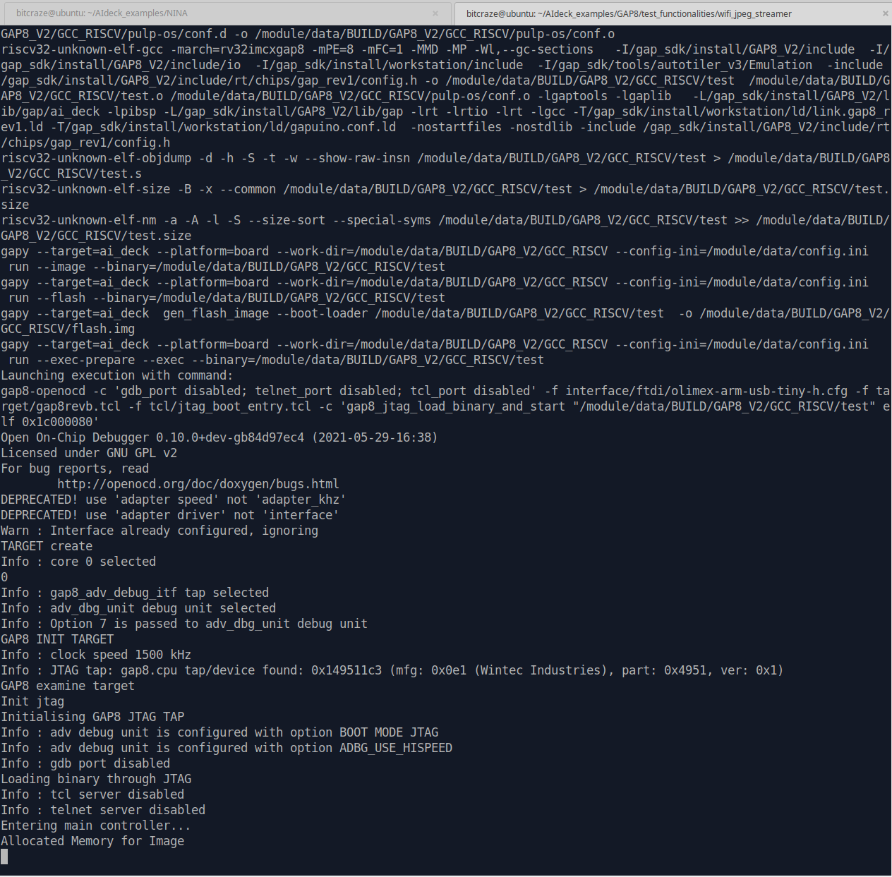

I took your advice and built the gap_sdk from the dockerfile successfully, however I am running into a strange issue when I am trying to run the wifi_jpeg_streamer example following the documentation given in this link:
https://github.com/bitcraze/AIdeck_exam ... er-gap8.md
When I try to build and run the example on RAM as described, I am able to connect to the gap8 device through the JTAG debugger, but the program halts at an arbitrary point before the transmission is started. For example, sometimes the program halts after displaying "Allocated Memory for Image" and sometimes even after displaying "Opened Streamer" but I have not yet been able to view the stream successfully with the "viewer.py" script which is perpetually "connecting" when running this example. I have attached an example of the output that hangs when I try to run from device RAM below:
Launching execution with command:
gap8-openocd -c 'gdb_port disabled; telnet_port disabled; tcl_port disabled' -f interface/ftdi/olimex-arm-usb-tiny-h.cfg -f target/gap8revb.tcl -f tcl/jtag_boot_entry.tcl -c 'gap8_jtag_load_binary_and_start "/module/data/BUILD/GAP8_V2/GCC_RISCV/test" elf 0x1c000080'
Open On-Chip Debugger 0.10.0+dev-gb84d97ec4 (2021-05-29-16:38)
Licensed under GNU GPL v2
For bug reports, read
http://openocd.org/doc/doxygen/bugs.html
DEPRECATED! use 'adapter speed' not 'adapter_khz'
DEPRECATED! use 'adapter driver' not 'interface'
Warn : Interface already configured, ignoring
TARGET create
Info : core 0 selected
0
Info : gap8_adv_debug_itf tap selected
Info : adv_dbg_unit debug unit selected
Info : Option 7 is passed to adv_dbg_unit debug unit
GAP8 INIT TARGET
Info : clock speed 1500 kHz
Info : JTAG tap: gap8.cpu tap/device found: 0x149511c3 (mfg: 0x0e1 (Wintec Industries), part: 0x4951, ver: 0x1)
GAP8 examine target
Init jtag
Initialising GAP8 JTAG TAP
Info : adv debug unit is configured with option BOOT MODE JTAG
Info : adv debug unit is configured with option ADBG_USE_HISPEED
Info : gdb port disabled
Loading binary through JTAG
Info : tcl server disabled
Info : telnet server disabled
Entering main controller...

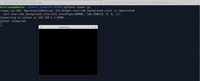

I am able to flash the wifi_jpeg_streamer example to the AI deck successfully, and I can see the wifi network "Bitcraze AI-Deck Example." I am unable to view the image stream, running "viewer.py" brings up a black window and reports the following in the terminal:
viewer.py
DeprecationWarning: Gtk.Widget.override_background_color is deprecated
self.override_background_color(Gtk.StateType.NORMAL, Gdk.RGBA(0, 0, 0, 1))
Connecting to socket on 192.168.4.1:5000...
I am unsure how to proceed at this point because I have not even been able to get the example working when using docker and following all of the documentation. Please let me know if there are any glaring mistakes in my approach, because I do not know what to try at this point. Out of the box the AI-Deck came flashed properly with the streaming example, but even then I was unable to connect with the python script.
viewer.py

Looks like it can't connect. Did you connect your PC to the "Bitcraze AI-Deck Example" Access Point?

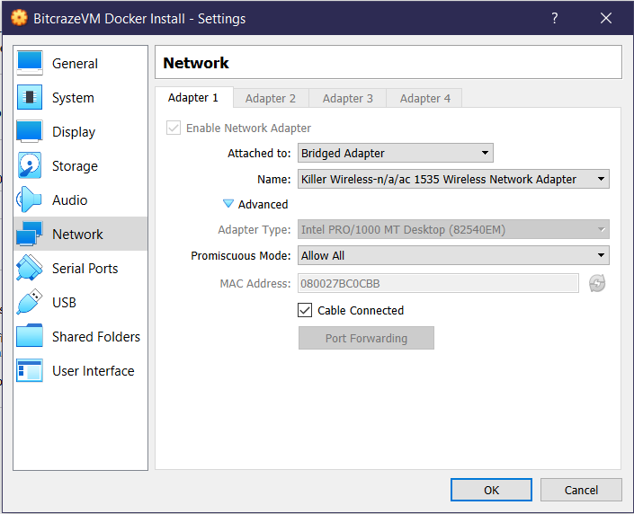

I am connecting to the access point on my PC. I am using the Bitcraze Virtual Machine with VirtualBox and I have set up a network adapter. I have attached a picture of my virtualbox settings (virtualbox_settings.png). I have attached a picture of the output of viewer.py which reports "connected" but does not show any output from the camera (viewer_socket_connected.png). I have attached a picture of the output of the "wifi_jpeg_streamer" example when running from RAM which still hangs at "Allocated Memory for Image" (wifi_jpeg_streamer.png). I am not sure what is causing this problem, but everything seems to be working properly aside from the network issues connecting to my virtual machine, I am able to successfully flash all of the examples, the problems arise when running examples that involve a network connection. I am going to try to try this from a native install of Ubuntu 18.04 to see if the primary cause is the network adapter between my virtual machine and PC. Have any similar issues been reported when running from a virtual machine? Please let me know if you have any suggestions or need more information.
Thank you,
Griffin

Re: AI Deck Flashing Issues
My guess is that it is a some form of security problem with the wifi and possibly running it though the VM. We have had it working though the VM but it was a while ago so possibly something has changed.
I now got time to test it and it is no problem for me to get it to connect using the VM. I did not do anything special other then increasing the video memory to get it to start.
So probably some access/security issue. Do both green LED on the AI-deck blink when you power it on. Also when it is connected the LED1 should start blinking faster.
