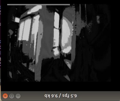

Hello
This is an example from the wifi streamer, it’s looking onto stairway and windows
Rodrigo
Rodrigo
- Posts: 1050
Re: Monochrome camera issue
That is an extremely weird behavior that I have not seen with the grayscale camera.

By the way the picture I sent i flipped it upside down for easier viewing.
Thank you
Regards
Rodrigo
