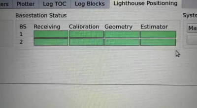

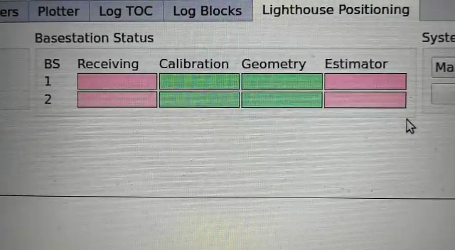

I am using two V2 basestations for the first time. I tried to set up everything, and I could set the channels for the base stations. Now I am trying to let a crazyflie fly with the V2 system, but I have the following problem.
These are screenshots from a video. As you can see, the colors for the Estimator and Receiving keep changing and never remain on green.

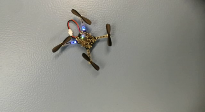

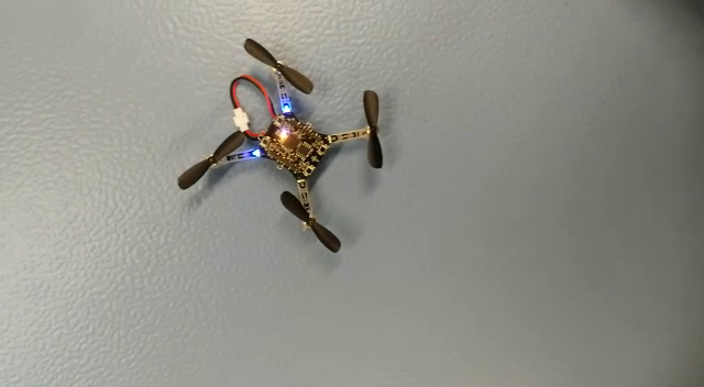

On the quad it looks like this
I have tried this on different Crazyflies and different lighthouse decks.

It sounds like there is some problem receiving the base stations.
How long are the base stations green and red?
What happens if you hold the Crazyflie up towards one of the base stations so that the other base station is not visible from the Crazyflie? Is that base station stable on green in the client?

In regard to your first question, I have two videos in this link https://github.com/sAz-G/open_folder.
In summary, the base stations remain mostly on green, and they change to red roughly every 5-6 seconds. They remain on red for <1s and then back to green for longer time. So it could look like the following: 5s green, 1s red, 5s green, 1s red, 5s green, 1s red.
Sometimes only one base changes to red and the other one stays on green: 5s green (b1, b2) , 1s red (b1), 5s green (b1, b2), 1s red (b2), 5s green(b1, b2) , 1s red (b1, b2).
In regard to the second question, I will try it first and let you know.

I looked at your video of the client and this behaviour is actually what is expected, I will try to explain what is happening and why V1 looks different.
In Lighthouse V1 the two base stations are synchronized (either optically or by a cable). The result is that the rotors in the two base stations are spinning exactly at the same rate and with a know phase in relation to each other. This means that the light sweeps from base station 1 and 2 will never collide, first there is a sweep from BS1 and after that from BS2 and so on. This also puts a hard limit of 2 base stations on the system.
In Lighthouse V2 Valve has chosen a different approach and there is no synchronization between base stations. When light sweeps from two base stations hit a sensor on the Crazyflie at the same time, the data is messed up and it is not possible to use the sweep for positioning so it is important to minimize this event and to make sure it is not happening at the same point in space all the time. The solution is to make sure the base stations run at slightly different frequencies (around 50 Hz, based on the channel) which makes the interference point mover around in time and space.
This is what you see when the reception goes red for a bit, the sweeps from the two base stations interfere. If you turn off one of the base stations the remaining one should stay green all the time.
It is not necessary to have reception all the time to fly, the Crazyflie can handle short gaps using other sensor data.
