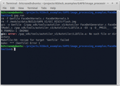

I am currently trying to run the face detection example with the ai-deck VM. It is telling me that the directory does not exist. The error is as follows:
I have verified that the file is in the correct directory:
I was wondering if there is something I am missing?
Thank you for your help.

hi!
The autotiler needs to be build separately due to licensing of Greenwaves. Follow the instructions from the line 'Open up the container to install the auto tiler'

Great! That was the problem, thank you so much.
