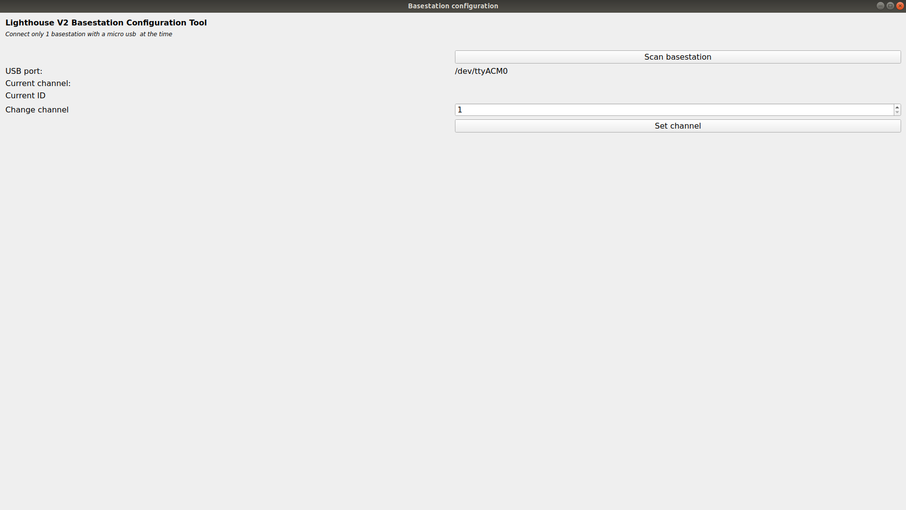

Hi everybody,
I am trying to set up the V2 system. To do this, I am using my pc whith ubutu 18.04.
I followed the video tutorial on https://www.bitcraze.io/category/lighthouse/ and the tutorial on https://www.bitcraze.io/documentation/t ... ighthouse/. On my screen it looks a bit different when I try to set the channels: and when I click set channels it looks like the following: . As you can see I don't get the success message, and the current channel and ID remain empty.
Is there something I missed?

First question is if you clicked the "Scan base station" button?
My guess is that you did as it found a port (/dev/ttyACM0 in your case).
What is missing though is the current channel and id that should have been filled in when the base station was scanned.
I don't know exactly what the problem is but let's try to figure it out.
Behind the scenes we are connecting to the base station as a serial port terminal and are issuing commands and parsing output. Since everything is reverse engineered, we don't really know that all base station firmware versions behave in the same way, so it is possible that your base station is doing something we don't expect.
It would be of great help if you could connect to the base station in a terminal window and see what it looks like for your base station. Use a terminal program like or (you might have to install one of them) and connect to the device indicated in the python client. In a terminal window do something like this:
When connected, hitting the the TAB key should give you a listing of all commands. Please post the list of commands here to let us know what it looks like. Thanks!
The commands we use to configure the base station is to get/set the channel and to get the id.

Hi, yes I scanned, without scanning it looks as the following
Here the screenshots of the terminal for one of the V2 basestations:
First running picocom:

Now, I assume that the channel is set to be 2 and the id is DEFAULT, just like in the documentation, correct?
Do I have to insert an option to change the channel? (for example mode 1 would change the channel to 1?)
Thanks!

I think the problem might be that your uses needs to be a member of the dialout grouop to access the serial port
We have documented this for the LPS Tools (https://github.com/bitcraze/lps-tools/b ... t-on-linux) that also uses the serial port, but it seems to be missing for the client. I'll add it.
sudo adduser $USER dialout-

Yes, that solved the problem (Note that the ID is not DEFAULT, I think it is the serial number). I had to add my user to the dialout group.
